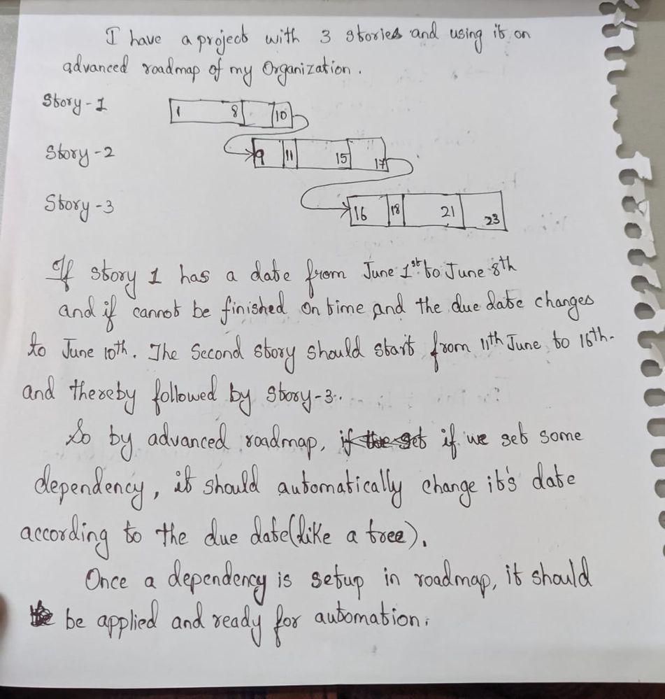

Give me any way to find a automation for this issue. Since this is used as a test purpose, Will be applying the automation in organization live set up.
Please provide a best solution for this ?
If the [Story-1] of Due Date ≠ Start Date of [Story - 2]
It should change the date when the due date is increased.
Once your Due date changes to 10th, the start date should change one day ahead like 11th of Story-

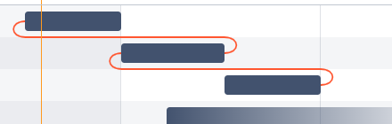

If you use Advanced Roadmaps (available only with the Premium plan) you can use the Auto-schedule feature to automatically maintain the dates between dependent tasks. Refer to

We tried the Auto-schedule option in Jira, but, we are not able to get a best option. So If I get a good option, then I would apply it in our work environment(i.e., on Advanced roadmap).
