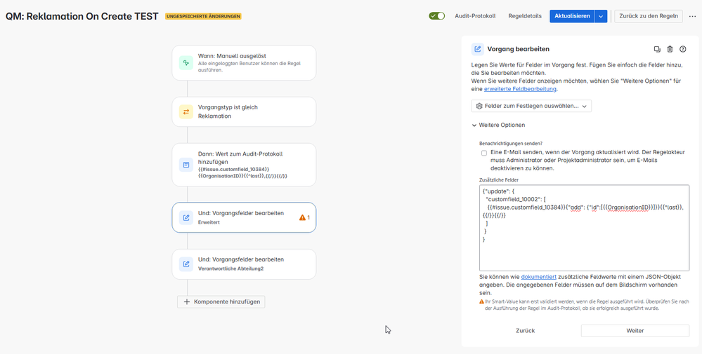

We want to add jira organizations by adding their organizationID with a automation which are stored as asset attributes.
If a user submits a work item and chooses one or more departments in the customfield "Responsible Departments" (customfield_10384) the organizationID stored as asset Attribute "OrganisationID" should be added as organization.
I tried adding those organizations like adding request participants in this documentation: Manage Request Participants with Automation in JSM Cloud | Jira and Jira Service Management | Atlassian Support
My edit issue-rule looks like this:
{"update": {
"customfield_10002": [
{{#issue.customfield_10384}}{"add": {"id":[{{OrganisationID}}]}}{{^last}},{{/}}{{/}}
I got the error: "Function value has to be a number (customfield_10002)"

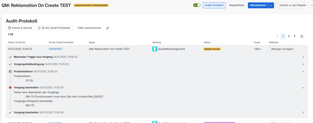

I added a additional protocol action to verify my input:
{{#issue.customfield_10384}}{{OrganisationID}}{{^last}},{{/}}{{/}}
returns:
211,78

Hi @Gerrit Wahlers , I faced the same issue and it took me hours to find that the solution is more simple when you find out that
a. Organizations (customfield_10002) does not support the syntax with"id" {"add": {"id":{{yourValue}}...
it has to be {"add": "{{yourvalue}}"} (without "id:") or else it will ALWAYS fails...
b. You can turn it any way you want, customfield_10002 seems to only support 1 single value at a time - it does not support list, arrays, etc...
Knowing this I tried the following and it worked for me (I adapted the script with your data)
1) Advanced Branching:
For each: Smart value = {{issue.customfield_10384}}
Var name = Orga
2) Edit work item (Advanced)
"update": {
"organizations":
[{"add": "{{Orga.OrganisationID}}"}
3) Re-fetch work item data <-- This one is important or else each new update will overwrite the previous value
Working as a charm for me - hope this will solve your pb
