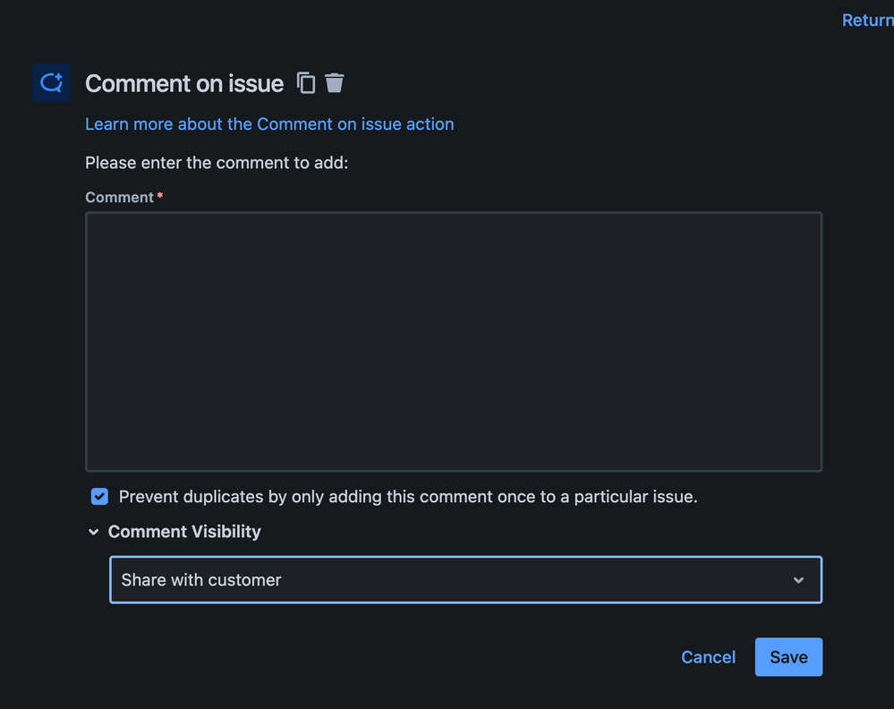

Do you have "share with customer" visibility set on the automation action?

Please take a look at @Fazila Ashraf suggestion. By default, the visibility is set to internal only.
If you have set it to "Share with customer" and it still isn't working, please provide screenshots of your automation and possibly your notification scheme so that we can take a better look at what might be going on.

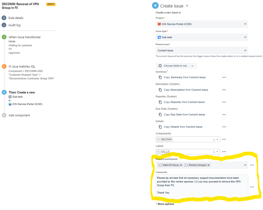

Thanks Paul and Fazila. That option doesn't appear available to me. I am able to enter a comment however the Comment Visibility option doesn't appear (I am using Data Center version)
I should add that I am adding the comment while creating a subtask. Here is a snapshot.
Rich Imbrogno
May 3, 2023
Instead of adding the comment as part of the sub-task created I've split the process up. I first created the subtask and then followed that up with "Then add comment" and that option allows for the window that you posted. I will try this out and report back if it resolves the issue. Thanks for your initial suggestion
