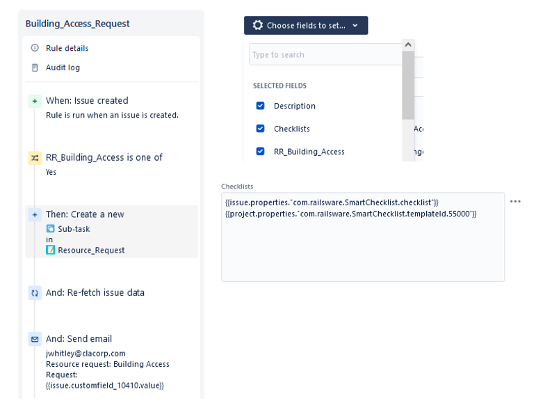

Hello
I am trying to find a way to add a smart checklist to subtasks based off the subtasks name. I have tried a few different directions but either a single checklist will show up for all subtasks or the checklist will show up in the main issue.
Example of what I am trying to build.
Thank you in advance for any advise that is given on this issue.

Unfortunately I have not been able to get this process to work. Currently I have built the below setup under two of the subtasks.
{{issue.properties."com.railsware.SmartChecklist.checklist"}}
{{project.properties."com.railsware.SmartChecklist.templateId.55000"}}
I am guessing I am missing mostly simple once you know what it is.
Thank you
Joanna

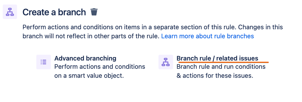

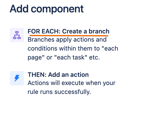

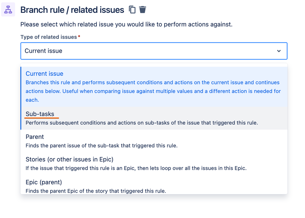

After a week of retrying and reworking this, The issue I am having is the checklist is showing up parent issue and not the sub task. Is there a way to make it show up in the sub task?
Hey, @Joanna Whitley
Can you try adding a component to the automation rule like FOR EACH: Create a brunch > Brunch rule/related issues. Then search for an available option in Type of related issues field. (I've attached some screenshots)
If this approach doesn't help, please ask Smart Checklist support and I'm sure they will come up with something. You can reach out to the support team at smartchecklist@railsware.com
Hope this helps,
Oleksandr
