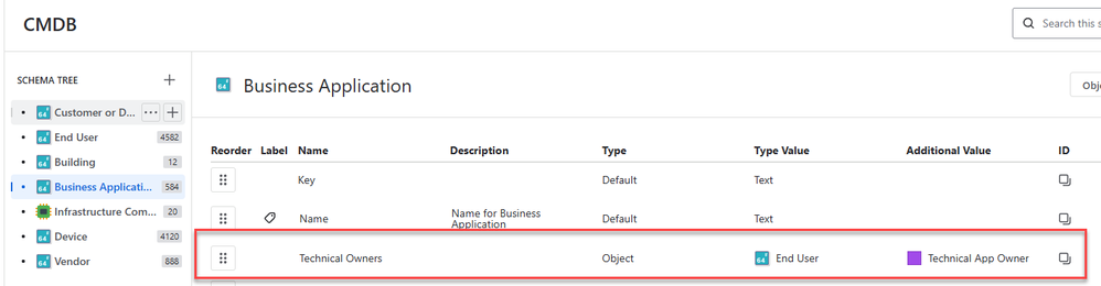

I have an attribute on an object that can store multiple references to other objects. In this case a 'Business Application' object that has a field for 'Technical Owners' that can hold multiple references to an 'End User' object.

Here is the Object configuration, I've highlighted the attribute technical-owners-attribute.png

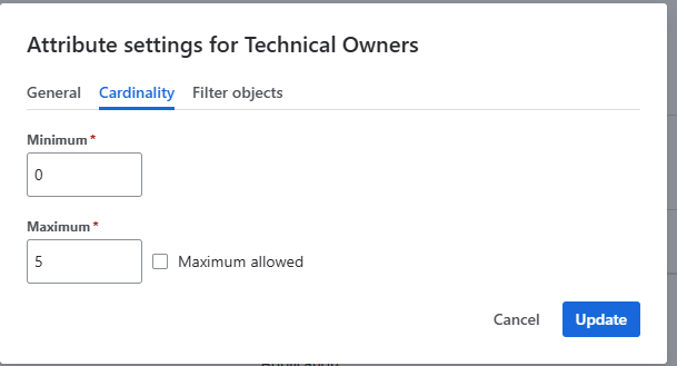

Here is the cardinality of that field; I don't have any issues putting multiple objects in there via the UI technical-owners-cardinality.png

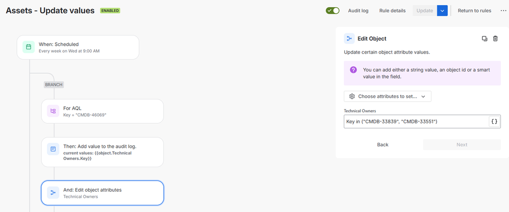

Here is the automation where I just simple AQL branch on one object, log the value of the 'Technical Owners' field and then try to update it; I'm just hardcoded all values right now to try and get it work.

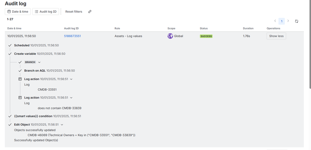

And finally, here is the audit log where it shows there is only one value in Technical Owners (the first log section) and then runs the Edit Object. It says it runs successfully but going to object shows that nothing changes
I have Key in ("CMDB-33551", "CMDB-33839")
in the Edit Object value right now, but I've tried many different formats with no success yet.
Edit: I have noticed that it will update based on Key in ("CMDB-33551", "CMDB-33839") - but it sets it to the last value in the list - it will not add multiple objects.
