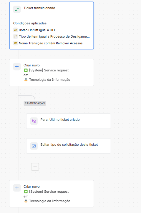

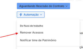

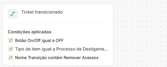

I created a button in a workflow to perform (From Any Status to Any Status).
I called the transition (button) Remever Acessos (Remove Acesses).
When the agent click on this button there are triggered some actions to open tickets in another project:
So, we are facing some problems related to this rule, tickets are created twice in the other project. The same ticket as the button was clicked twice. Thiniking to avoid this behavior I used a custom field Botão On/Off as a flag. This is, in the first time the user click the button and the action was performed, the Botão On/Off is set to ON. So, on the next time, the button has no effect.
On more information is that the email sent in the end of the flow was been sent only once, there is no duplicated email. So, I suggest there is something wrong with the Create Issue action.
Could you help?
Tks.
Jader

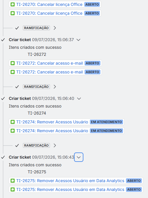

In the audit log is showing it is executed twice:
It looks like some strange that the tickets have the same ID in the audit log. But look the linked issues we can see different ticket IDs.
Hi Mikael,
thanks, it explain the duplicated tickets in audit log.
But the problem persists. I still have the creation of two tickets in each "Create Issue" command. And it only happens using the action button. I have the same actions in another point of the workflow and it works Ok.

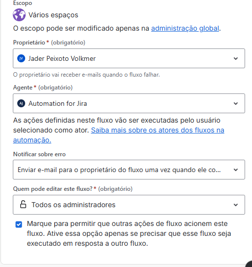

If not, is the box checked for the rule that says to allow it to execute from another rule? It is on the Rule Details page.
Okay, asking again - does this fire because another automation rule moves the work item into the Remover Acessos status? Or does the user manually move it to that status?
If manual, then I suggest you remove the check box as that might be what is causing it to fire twice.
Hi John, make sense remove the check box. I did it and I will be waiting for the next execution of the workflow.

I used this procedure:
Add a looped transition to perform transition actions
in the Atlassian documentation:
https://support.atlassian.com/jira-cloud-administration/docs/create-workflow-transitions/
So, then I create this flow that is executed in that transition. To make sure that the operation will be executed only in this transition I created a custom field called Nome Transição where I write the transition name (Remover Acessos) when the customer click on the button (bellow)

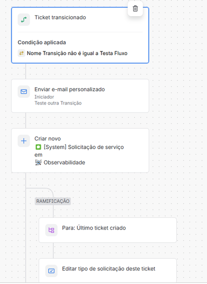

Hi @John Funk ,

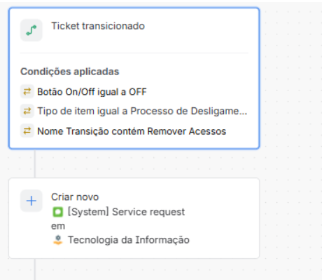

I made an experiment to evaluate the solution. I have a test's space where I can validade some implementations.
So, I created similar situation in my WebDocs project:
I created a Testa Fluxo transition when I execute the Testa Fluxo using the button on actions menu it trigger the action above. There are a ticket being openned on the Observalidade space. It works properly and works once.
Similar situations, different results, I am trying to find out why in RH space, using Remover Acessos button the actions are executed twice..
Then I suggest you completely build a new rule for the project where it is not working. Do not use copy and paste, but create each step from scratch.

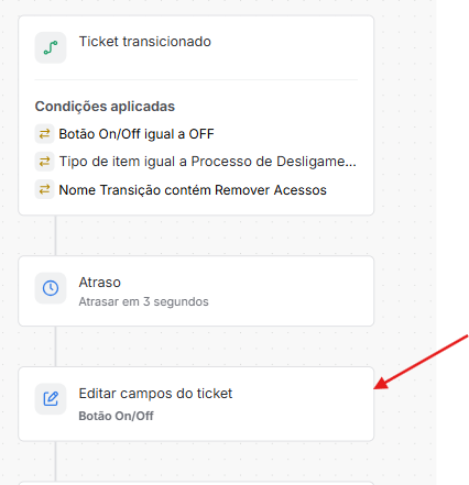

Hi all,
I think I found a solution for this particular case.

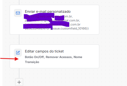

In the begining, the trigger, I test the Botão ON/OFF flag created to not allow execution of the flow. This flag was already there but was set at the final of the flow.
So, instead of set this flag at the end of the flow, I set to ON at the begining, and the first results was good.
The first executions of the flow show good results and no duplicated actions.
I will keep monitoring, but would like to thank you for your help and contribution.
