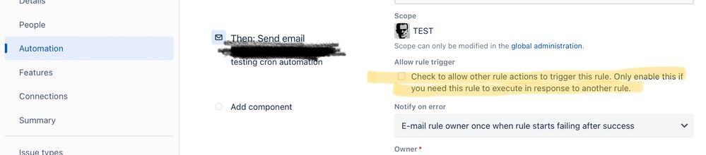

I don't know of any specific example. Below is the rule setting that allow a rule to be triggered by another rule. If you could detail your goal maybe I could assist further.

Thank you for your reply. I understand the settings on the side that receives the trigger, but what happens to the other trigger?

I don't understand your question. Let me try to give a theoretical (but stupid) example...
rule 1
  • trigger - issue created
  • condition - type = improvement
  • action - transition issue to "in progress"
  • action - edit issue "loop count limit" incremented +1
rule 2
  • trigger - issue transitioned
  • condition - field condition "loop count limit" < 10
  • action - create issue of type improvement
both rules have the "allow other rule actions..." checkbox enabled
Now if I recall there are automation loop safe guards that could prevent the above but I have not validated this.
Again, without understanding what you're trying to achieve the above example may be totally useless. I just don't have enough information to give you sound device in my opinion.
