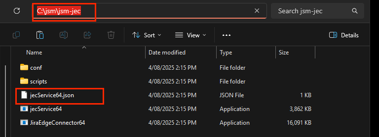

  2. In your C drive, create a folder name jsm and within it create a subfolder jsm-jec. (Note: the location and name can be per your requirement. We have left is as default so we do not have to make changes to the JEC config file)
  3. Extract the content of the jsm-jec-1.0.2-win-amd64.zip into the jsm-jec folder
  4. Go to the jsm-jec folder and then rename the jecService64.json.example to jecService64.json

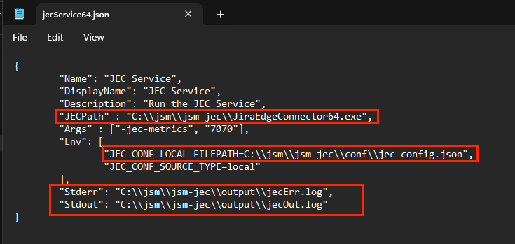

  5. Open the jecService64.json file in Notepad or your preferred text text editor. If you have chosen a different name or location than that from step 2 above, make sure to update the paths below to match your chosen folder name/location.

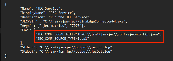

  1. Setting environment variable: We have two options to read the configuration file, either local or using git. In this article we will be setting up JEC to use local drive.
    1. Go to “C:\jsm\jsm-jec\conf” folder and edit the jecService64.json file
      1. Under “Env” make sure the "JEC_CONF_LOCAL_FILEPATH" is pointing to the conf folder (part of the package downloaded) and "JEC_CONF_SOURCE_TYPE" is set to “local
      2. “Stderr” and “Stdout” is pointing to the correct path. Note: if the output folder does not exists in the path, you will need to create one.
