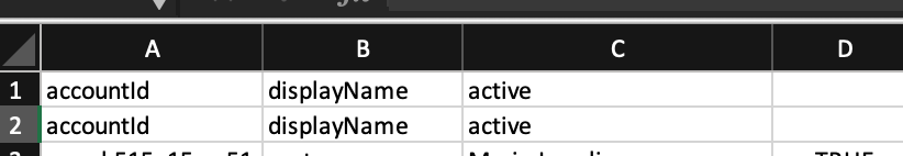

Yup - have worked it out. In the reporting.py file, the variable f is storing 4 arguments, but we're not defining those in the expected dict.
We're missing the reading of account_type from this.
I fixed it by adding the following line to the for loop on line 1474:
account_type = f.account_type
and then appended it to the OrderedDict in both if isInstance
"accountType": account_type,
self.user_list.append(OrderedDict({"accountId": get_user, "accountType": account_type,
"displayName": display_name, "active": status}))
That seems to have rectified the issue. Not sure why I could run the script before without having this error.
Confirmed by opening that CSV, adding that code and then reopening the csv which now has the accountType column heading. Below is the headings before I amended with above code.
Prince Nyeche - ELFAPP
Atlassian Partner
July 28, 2022
I don't think that was the cause. The for loop is suppose to receive the data after being read from the file and the file is written by searching get_all_users method. Looking at the file you've shown, it seems that the failure occurs when trying to read row 2. For some reason, the file itself is mutated with a header. Now I remember, the reason I added skip=True argument is because of this reason, I never got around fully resolving this issue just added a workaround. Although, in your instance it wrote the header twice, that why this problem happened. Please can you create a bug here with the steps you did? So I can add this to the next releases or the one after that.
The main cause is that a header is written to the file which shouldn't happen with the get_all_users.I think this is because of the ordered dict class but I need to trace why and how it can mutate a file that's already saved.
Atlassian Partner
July 28, 2022
Okay, I think I know the reason why.Since the call to USER.search_user happens consecutively, there's a rewrite of the file and the self.user_list stores all the entries. Somehow it takes the keys of ordered dict values and appends that when rewriting the file hence this problem. Changing the code as a workaround is okay but I need to fix the behaviour of that method as that's not how it should function. It shouldn't be updating the file even with multiple calls to it. The exception is only when there's a difference in user size.
Atlassian Partner
July 29, 2022
Hey @Robert Rodrigues I did a patch of the code which you can use instead rather than rewriting the headers as the headers shouldn't be written to the file and the call shouldn't be updating the list all the time as that takes time when you're running larger dataset. With this behaviour, it creates the file once when performing a bigger list. Now you can do away with this line
Before:
USER.search_user(names, pull="active", user_type="customer", skip=True)
After:
USER.search_user(names, pull="active", user_type="customer")
 I still have other features which I'm bringing, so waiting to complete that first before pushing to a new version, thought I fix this since it's something I should have fixed but forgotten about it down the road.
