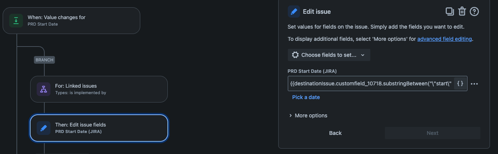

Hi All!
I am trying to write an automation where a Start Date in JPD is copied over to the JIRA Start Date field when the Delivery ticket is spun up. I have followed along THIS link which talks about string processing but have been unable to successfully get the date set on my JIRA ticket from JPD. PRD Start Date is coming from JPD and is cf107178. I did make sure that his automation was a global automation since it spans two projects.

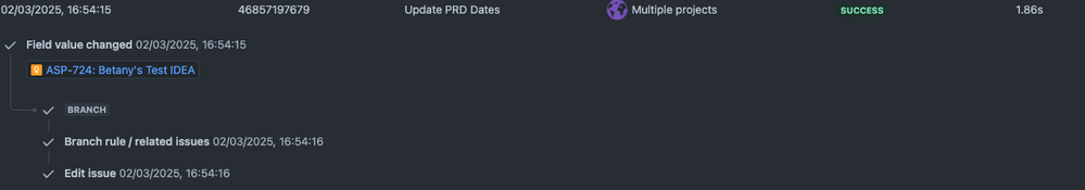

When the rule runs, I receive a "Success" Message in my audit log, but nothing is actually in the PRD Start Date (JIRA) field in my JIRA project.

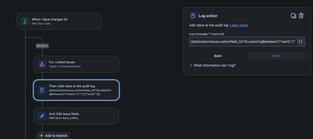

First, I recommend writing that smart value expression to the audit log, using the Log action. That will help diagnose rules like this.

Would you please post the complete smart value expression used to update that date field?
Also, is the PRD Start Date (JIRA) field a date-picker field type, configured in the global (i.e., company managed) settings?
Hi @Bill Sheboy !
SmartValue Expression: {{destinationIssue.customfield_10718.substringBetween("\"start\":\"","\",\"end\"")}}

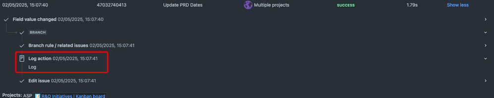

I did add a "Log" to the automation, and the log was empty. So that tells me the automation isn't picking up the value from JPD (cf_10718)
I also added myself as the actor on the automation in case there was a permset issue.
Ah, the smart value {{destinationIssue}} only applies with the link-related triggers: https://support.atlassian.com/cloud-automation/docs/jira-automation-triggers/#Issue-linked
You appear to be getting the date from the trigger issue, correct? If so, please change to this:
{{triggerIssue.customfield_10718.substringBetween("\"start\":\"","\",\"end\"")}}
OH MY GOODNESS!!!! That was IT! Thank you so much for walking me through this! I never thought about using trigger issue as I was in the "linked Issue" branch! Thanks Again @Bill Sheboy !
