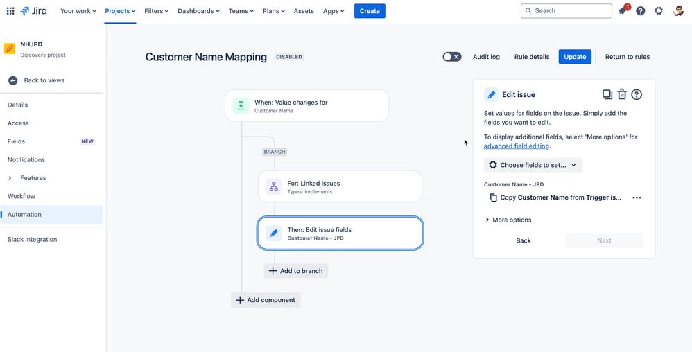

We've found an automation like this one below works well when trying to map Jira delivery fields back to the linked JPD idea when the delivery is updated:
  • WHEN: Value changes for Jira delivery field(s)
    • Select the delivery field(s)
      • In the example above, the automation is monitoring the Customer Name (Jira) field
  • BRANCH: Branch rule / related issues
    • Type of related issues = Linked issues
    • Link types = Implements
  • THEN: Edit issue fields
    • Select the JPD idea field(s)
      • In the example above, the automation is monitoring the Customer Name - JPD (JPD) field
      • NOTE this is copying the Customer Name (Jira) field from the Trigger issue

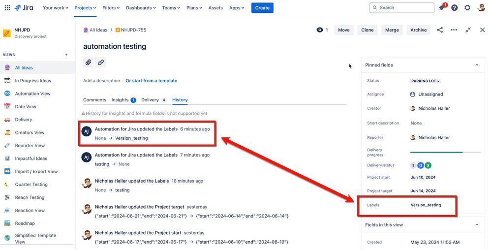

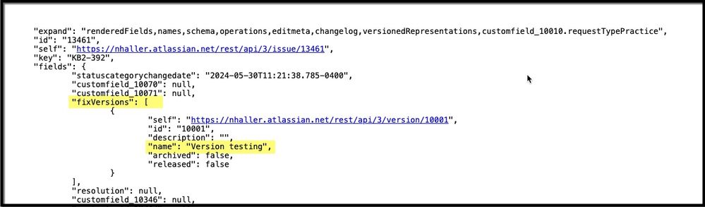

When using the Get Issue API on a Jira issue that has the Fix Version field configured, I noticed it's an array:
I know the Labels field is also an array field - so I configured a similar automation (to what I previously shared), and used a Smart value to enter the Fix Version value into the Label field of the idea:
{{triggerIssue.fixVersions.name}}

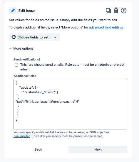

Hi Bill - Sorry for the delay. Here is the full workflow:
For that last step, that's where I"m having issues. For JPD, I tried a Single Select at first, which was obviously wrong as Fix Versions can be multi select. I then tried multi-select field in JPD project, and still nada. Finally, I gave up and just did a short text, which fills it, but unideal as I'd rather it be an option that can be filtered on. oh well.
If thetrigger issue has Fix Version of 9.1, then the new custom field in JPD's value is [9.1].
Likewise, if its 9.1 and 9.3, then the value in JPD is [9.1,9.3]
I can't get it to display w/o the [ ] wrap.
Lastly, the error I'm getting when the custom field is not a text (but is a multi-select field type) is:
Error editing issues
IDEA-180 (Specify the value for Version Released in an array (Version Released))

As for extracting the value within [ ] , try something like this using string processing:
{{triggerIssue.fixVersions.name.substringBetween("[","]")}}

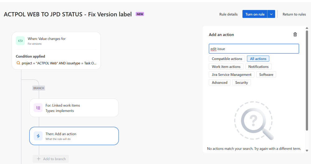

Hi @Louise Baker @Bill Sheboy @Nick Haller, I know that this topic is over a year old, but I happen to be trying to set up a similar automation.
I have followed the above steps more or less as needed. However, I am stuck where I need to Add an action for the linked work items. That step, as Nick and Louise have shown above, is to "Edit issue fields".
However, I am not finding the "Edit issue fields" option:
It's probably something simple, but I can't figure it out. Any idea from your side? Appreciate it.

Hi @Boris Ahrendt -- Welcome to the Atlassian Community!
This is a very old thread, and so I recommend creating a new question with the "Ask a question" button at the top of the page.
Until we see your new question...Please note Atlassian is in the process of renaming "issue" to "work item", so look for the "Edit Work Item" action.
