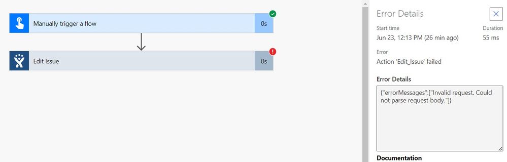

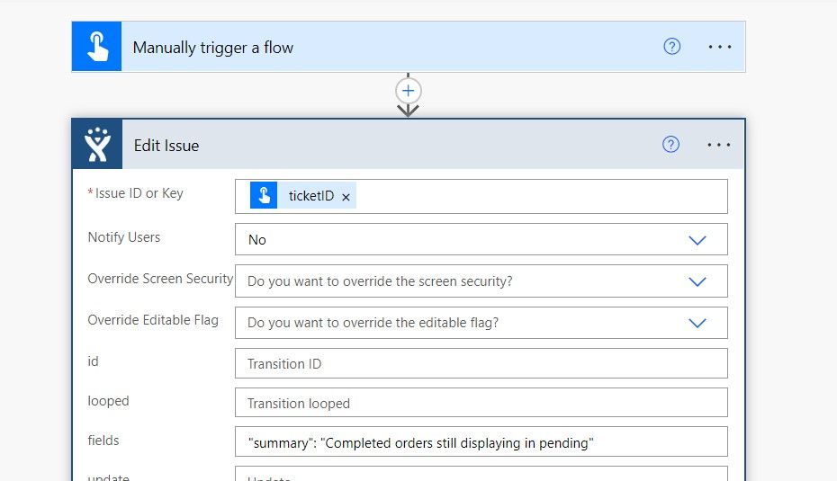

Hello, this is my first time on JIRA Community, we are trying to use Power Automate to edit a JIRA issue, however, when we are passing values in fields text field, we are getting errors, attaching screenshots:
This is the flow body that we are using, we are trying to update summary field.

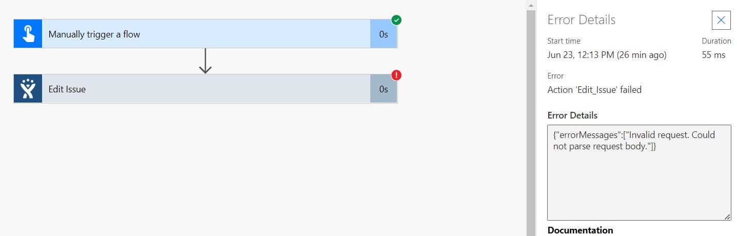

This is the error that we are getting:
we want to know how should we pass the field/update parameters values, so that it should get updated for the respective ticket ID.
You need to put it as json, like below. it will work

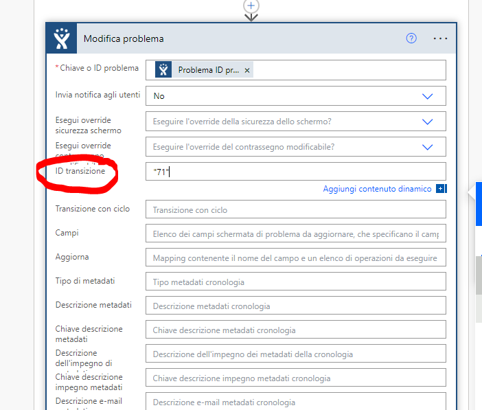

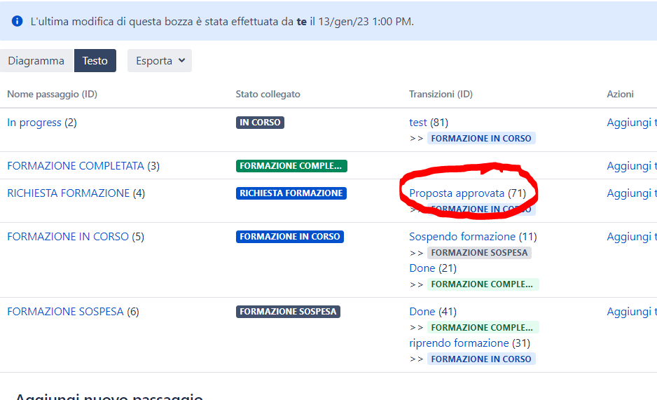

That's a good call, I definitely will need to keep custom fields in mind for the future. We don't store our issue's status as a custom field though, we just store it in the status. From what I've seen so far, I think I'm supposed to do something with the transition ID, but I just haven't been able to figure it out yet.
That is a good point in return. I have also used PowerShell to update the status of issues and in that case, you are correct that it was an issue transition that needed to be done for it to work properly.
If you want to go down that "rabbit hole", I used the JiraPS PowerShell module and the PS command is Invoke-JiraIssueTransition -Issue IssueID -Transition TransitionID
No need to go down the rabbit hole, I think. The transition ID is provided in the Power Automate for the "Edit Issue". Look at OPs 5th field in the picture.
@Michael Bruno Hi Michael. I'm facing the same issue at upadting the a ticket status
I've filled the transition ID field with the value of the transition I see in my flow
I tried with and without brackets but I still receive the same error. Moreover I don't know If I need to fill more fields. There's no documentation at all. I thank you in advance, Pas
Hey Pas,
Sorry, but I have no better information than you do. I have tried just about every method I can think of for formatting the TransitionId and I haven't been successful getting it to change. Without access to the underlying API or better documentation I have no clue on how to make it work. It does seem a field is required to use this Automate action though, so if you are going to keep trying, I would recommend putting in a field value that just changes a field to the value it already is (i.e., change existing priority medium to priority medium).
