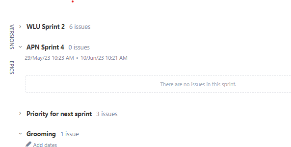

Hi Community,
I have seen my 1st project sprint into my 2nd project backlog.
How to resolve the issue. screenshot mentioned below.
4 comments
Comment
Log in or Sign up to comment
Jason Waller
May 28, 2023
The filter for the board needs to be configured to just show the issues from second project
Like Tarun Saxena likes this
Jason Waller
May 28, 2023
Filter query will need to be something like project = APN AND issue type = All
although you may also want to limit which issue types are displayed also

Amit Bansal
May 28, 2023
Pls. check if any sprint candidate is not accidentally mapped to non-required sprint and in different project.
Rohit
May 29, 2023
This usually happens in two occasions:
1. When the Board Filter is not correctly configured. In that case, you can check in Board Settings -> General -> Filter Query
2. Other scenario is that, if the first Project Jira Issues are tracked with the Sprint belonging to Second Project or vice versa.
Validate the same.
Like Taranjeet Singh likes this
Majken Longlade
May 29, 2023
Yes, to give a more specific example, if an issue was in Project ABC and included in Sprint ABC, and then it's decided to move the issue to Project DEF, the issue will remain in Sprint ABC unless it's explicitly removed.
People generally assume moving the issue will move it out of the sprint as well.

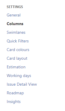

A couple of other things to look out for, aside from the board filter, as others have mentioned:
  • Check all statuses are mapped to columns in the board; if the issue has an unmapped status, it will not display
    • Go to Board Settings > Columns
    • On the right hand side of the screen, check if you have unmapped columns
  • Check you haven't accidentally applied a quick filter or an Epic filter that excludes the issues you are looking for
    • In the Backlog view, check if any filters applied and click 'Clear filters' if there are any
Hope that helps, let us know if your issue was resolved :)
