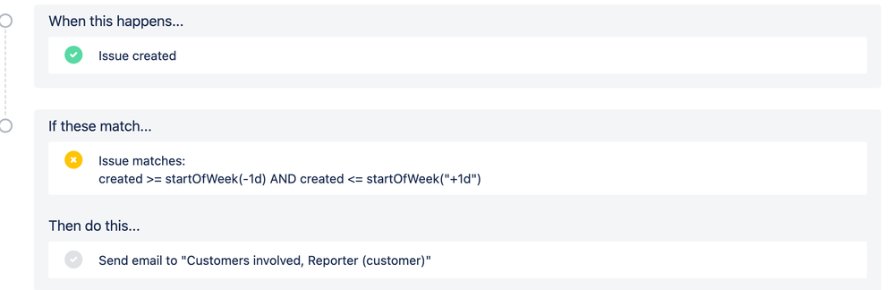

Hi all. I am looking for assistance on a custom JSM notification I've created in Legacy Automation that is not executing due to the JQL condition not being met.
I am a bit confused because the JQL query works when I type it in the search issues and successfully pulls up the issues that meet the condition. This is the query: (created >= startOfWeek("-1d") AND created <= startOfWeek("+1d"))
The query is checking for issues created on Saturday and Sunday.
My custom alert logic is simple:
When an issue is created,
if (created >= startOfWeek("-1d") AND created <= startOfWeek("+1d"))
then send an email
Thanks in advance for the assistance
Natasha
Solved! Go to Solution.

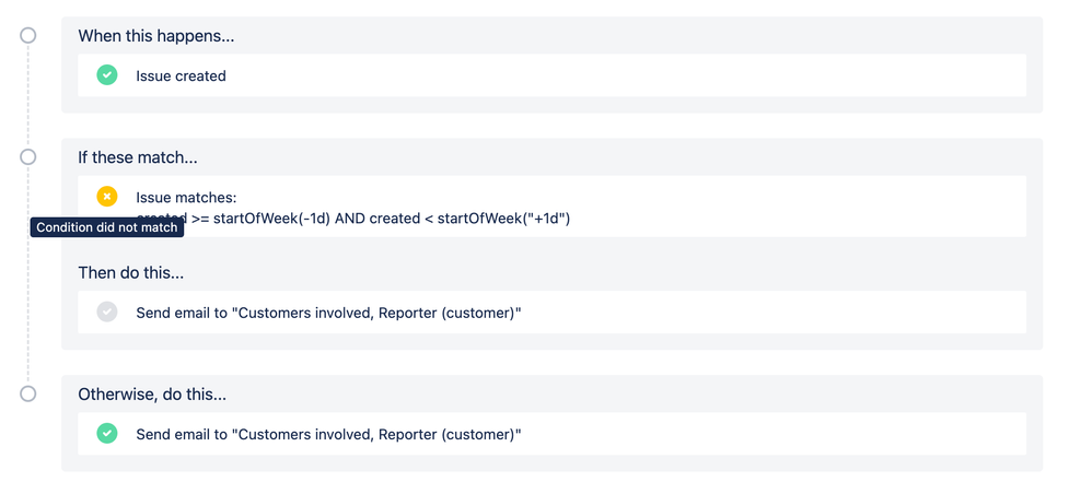

Bugger. Removing that AND clause doesn't exclude weekdays.
Your JQL statement in your post should work for issues created in the most recent weekend, with a slight change though:
created >= startOfWeek("-1d") AND created < startOfWeek("+1d")Can you share a (redacted) screenshot of your automation rule?
What don't you expect to see in the results?
Hi Kalin. Thanks for the response and yes, I want to capture tickets that come in over the weekend and basically send an email to the customer saying you've reached us after hours, etc.
When I removed this part 'AND created <= startOfWeek("+1d"))' the results returned tickets created on Monday. I am in Chicago so was testing this over the weekend last night. I created a ticket after Midnight and the JQL included that ticket when I removed the AND clause. Not what I want.
So the original JQL query works to filter only to Saturday and Sunday but for some reason, the Custom Notification I created didn't execute because it said conditions weren't met.
I wonder if maybe the rule is looking for the ticket to exist first and then evaluate the date? But that can't be right because it should be checked when the issue is created.
Screenshots of Custom rule attached

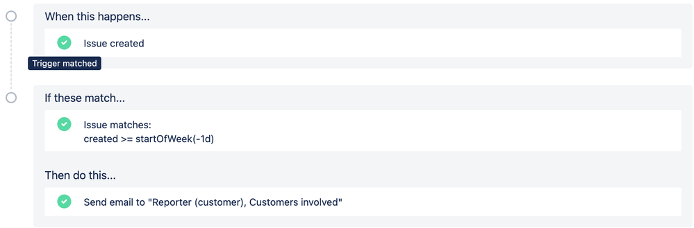

My man. I think your slight change did it. Removed the = in the second part of the clause and just sent a ticket and it executed the way I wanted. I'll have to wait until the weekend though to see if it's working for Saturday and Sunday.

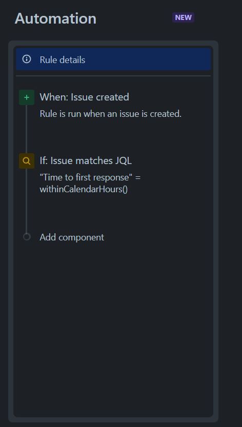

Since I also needed to implement this automation for holidays and after-hours during the week, I went with the solution suggested by Cassie and used withinCalendarHours(). I ran into the same issue though with the rule executing too quickly before the SLA timer could be applied. This is actually a known issue
https://jira.atlassian.com/browse/JSDCLOUD-8893
I just found a workaround using the tidbit from these articles. I stacked the re-fetch issue option 10x before executing the IF and that worked. It is not pretty but gets the job done for me for now.

@Natasha Richardson I would approach this a bit differently. I would make sure I have SLA calendars in my JSM desks are set correctly to match my Agents's schedules. Then I would use SLA JQL:
withincalendarhours()
to filters issues whose SLA clock is not running according to the SLA calendar.
I hope this helps!

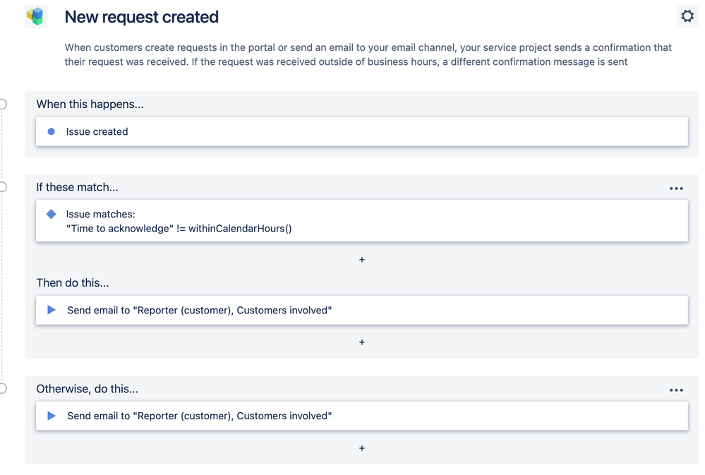

Hi,
I'm not having much success with this feature. We have our calendars created and time to acknowledge and time to resolution SLAs set up. I'm using the legacy automation bc the format of the notification looks like the standard customer notification but for some reason the automation doesnt seem to be detecting the issues sla isnt running when i create a test ticket. I have today's date in as a holiday just for testing purposes and I've tried with '=' and '!='
Am I missing something here?
TI
Answer accepted with one caveat, you will need to stack the re-fetch issue action to the automation otherwise, running this with the Issue Created option doesnt allow time for the SLA timer to be evaluated before the rule completes. Same goes for trying to evaluate the created date field.
This is a known issue:
Post on re-fetch

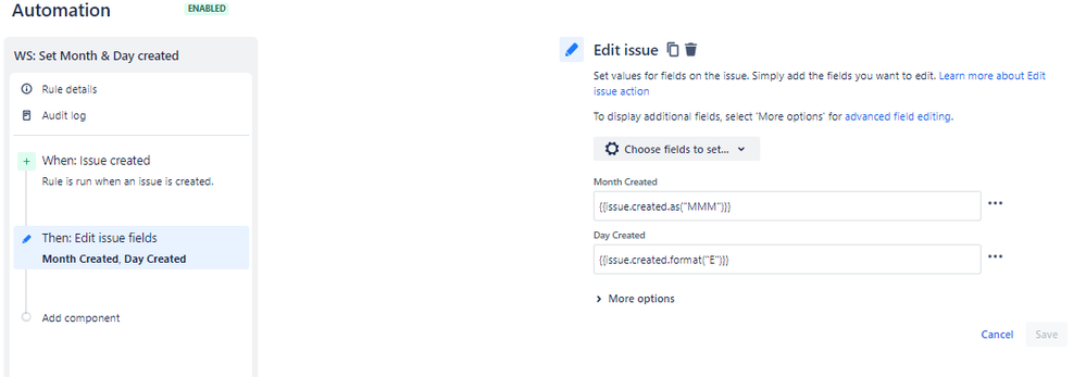

Suggesting a slightly clunkier approach from how I've set stuff up on our service desk.
For context, we track the day and month issues are created as custom fields for reporting and trend purposes using the following automation rule:
Following on from the above it would certainly simplify the JQL for your notification rule to be :
"Day Created" in (Sat,Sun)

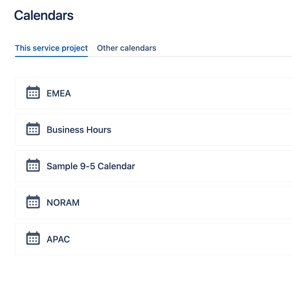

Thanks. I'm going to try Cassie's approach because we need to include Holiday hours as well for all of our locations and we can plug in Holidays in the SLA calendars so this should be easy but it's not working for me.
