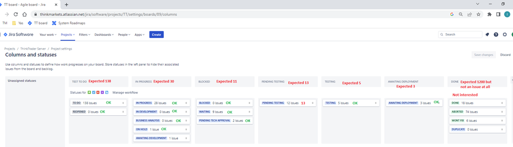

We migrated a Company managed project to a team-managed one.

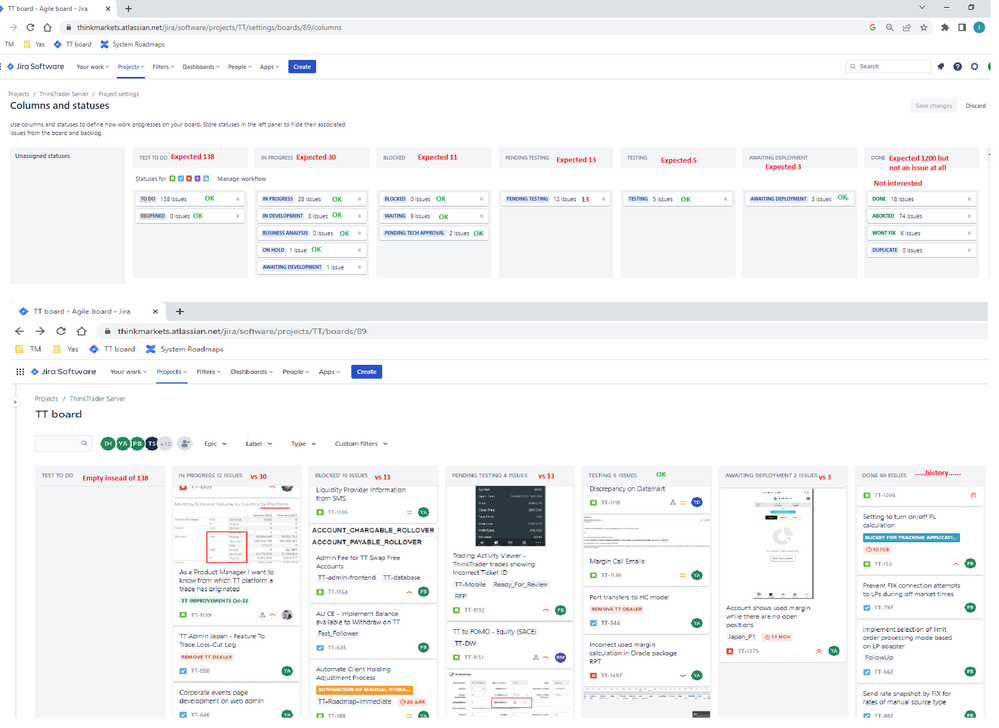

Unfortunately, the Kanban board is not showing all the issues in some, and no issues for other status columns (see below). For example, we have more than 100 issues in To Do and >1000 in Done.
Filters using the status category are working fine.
The board doesn't show any issue in To Do and just 1 in Done. When See all Done issues is pressed all 1000+ issues are there displayed properly.
When I'm on the Columns and statuses configuration screen some numbers are there, but still not the actual ones.

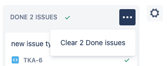

You could manually clear the right-most column of done issues by clicking on the ... button at the top of the column. I think that will enable more issues to display in the other columns of the board.

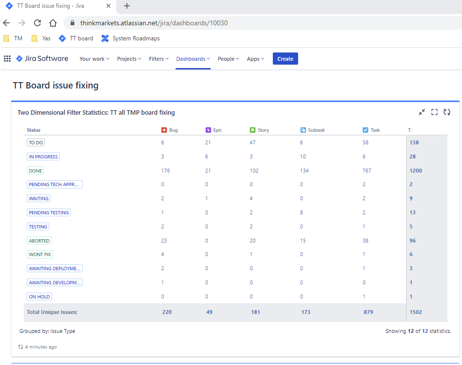

1. we have 1502 issues (snapshot below) and it looks like the limit of 5000 will not affect us soon.

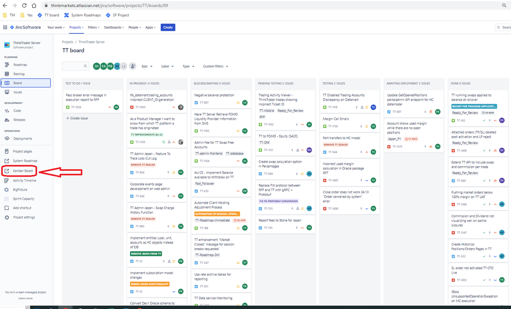

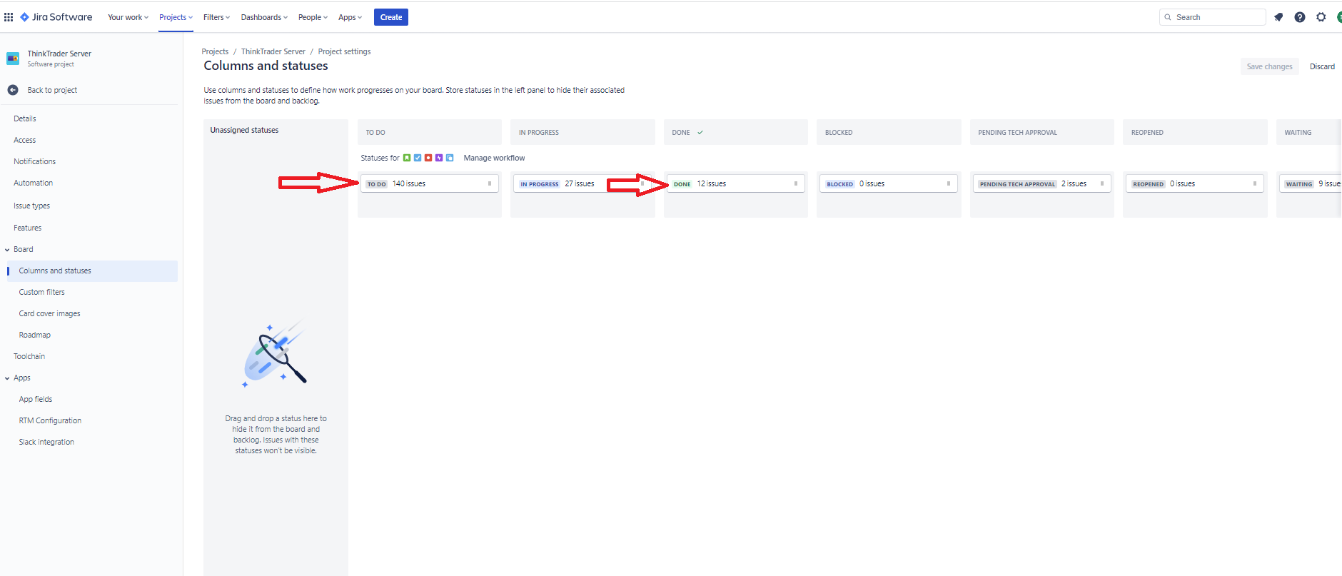

On the board configuration screen(picture 3 below), the numbers look pretty good.

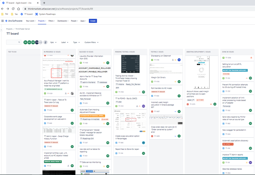

The numbers on the actual board(visible by users) (picture 4 below) are quite different.

1. Board configuration and actual boards compared
The aim of this is to showcase the issue
2. Dashboard based on the filter project = "ThinkTrader Server"
3. Jira board configuration screen
Some minor discrepancies
4. Jira board actual view presented to users

I notice from the image in your original post that you have the Backlog screen enabled.
With a Team Managed project Kanban board an issue can be in any status and be displayed in either the Backlog list or on the Board. When you are looking at the Board configuration, the number of issues it is showing for each status is a combination of the issues that would display on the Board and in the Backlog.
Are the issues that are "missing" from the Board display showing up in the Backlog list on the Backlog screen?
Additionally that count you see in the Board configuration includes all types of issues, but not all types of issues will display on the Board at one time. Team Managed project Kanban boards have a Group By option in the upper right corner. When you have None selected there you may notice that neither Epics nor Subtasks display on the Board. But those are being counted when you look at the issue counts for each status in the Board Configuration.

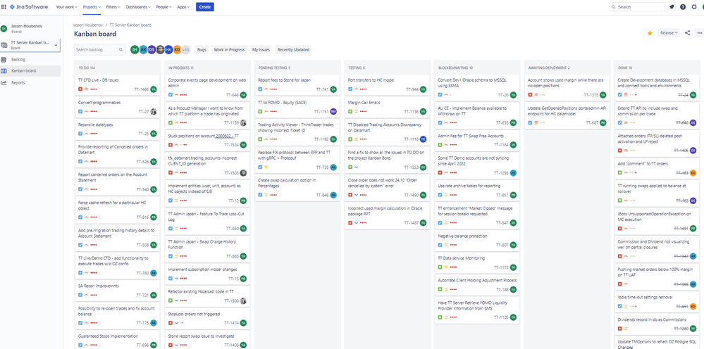

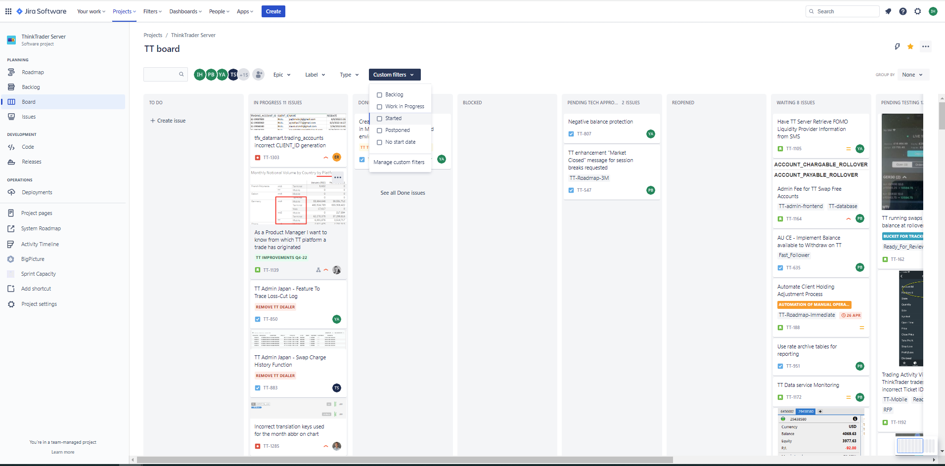

As a workaround, I have created a personal Kanban board, based on a shared filter and have added a link to the board as described here: - https://community.atlassian.com/t5/Jira-Software-articles/Multiple-boards-in-Business-and-Team-Managed-Projects-You-bet/ba-p/1719761
The result:
1. User can click on the link (picture 1) and see my board  (picture 2).
2. I can edit the filter query as needed, including the order by clause.
3. End users can see the new board.

1. "Standard board"
2. Custom board
