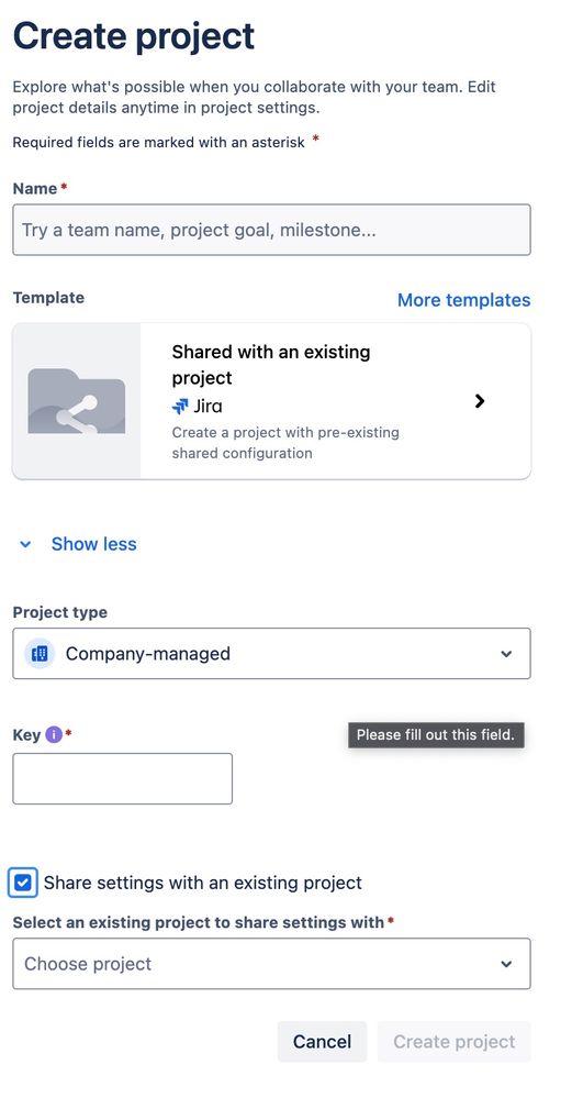

With the new change to Create Project, I have to do this:
1. Projects > Create Project
2. Pick any template.
3. Click "Use template"
4. Click "Select a company managed project"
5. Select "Share settings with an existing project"
6. Select the project you want to base it on.

The setting y'all want to poke around for is a checkbox called, "Share settings with an existing project". UIs change, so look around for that verbiage.
Currently, there are some rules around when you can perform this action, but in general "Team Managed" projects cannot be copied from other projects, even other Team Managed projects. Behaviors I saw:
I have used the "Share setting ..." options but looks like it copied only the issue types. I want to create new projects from an existing one so that all the automation rules, the workflow and the validators written on the workflow get copied. Basically everything other than the tickets should get copied. Any suggestions are appreciated.
Has anything changed in that regard as of the current date (November 2024)?
I'm no longer seeing this as an option when creating a new project. Has this functionality been removed?
For once, I revisited the process, and it's still the same for me. It does have to be a Company Managed project, or you won't have that option.
I did notice that if I picked a different template like Document Approval, then the initial screen let me pick Company Managed and had the Share Settings option. Here's what I'm seeing:
