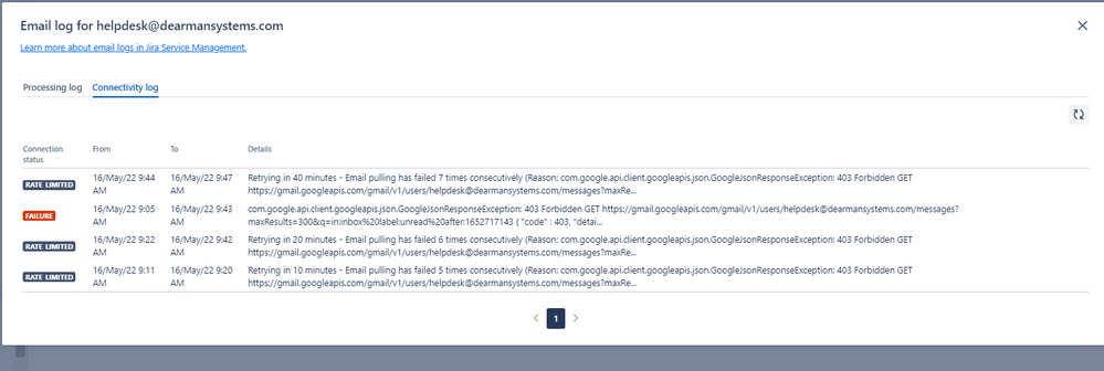

Hi. My IT department wants us to use Gmail instead of the Atlassian email for our service desk. I have no idea what to do. I have this error. Any ideas? Thanks.

Please take a look here: Unable to connect custom email account (atlassian.com)
Thanks. it looks like the error cleared now. But I am still not getting any email.
