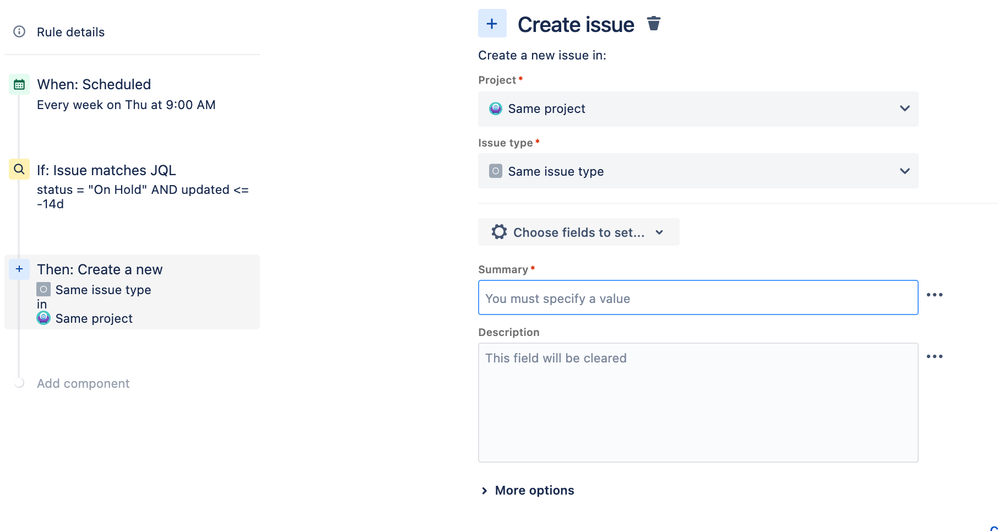

Margareta Buruian
September 9, 2021
Looks like this at a super top level

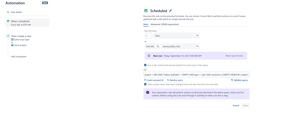

From the OP, it sounds like the concern is that his rule creates multiple tickets when he wants just one ticket created. I suspect the problem isn't the trigger or using JQL.
Is that right, @Jacob Rosenfeld? If so, it would help us to see a screenshot of your rule (similar to what @Margareta Buruian illustrated above).
Jacob Rosenfeld
September 9, 2021
Correct. It wasn't just the issue creation, I also wanted them linked within the issue.
This is the rule that made a new issue for each issue returned.
Mykenna Cepek
September 9, 2021
I notice in your trigger that you have this box checked:
Note how this says that it will execute actions (your "Create issue" component) for each issue in the JQL result.
Have you tried unchecking that box and testing the rule?

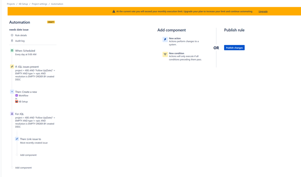

To run a rule once per day, you do need to use the Schedule trigger. So uncheck the box and skip the JQL in the trigger component of the rule.
Here is some pseudocode for what I suggest for your rule (after the trigger):
1. Terminate early if no issues match your JQL
2. Create a new issue
3. Loop through the JQL and link to the new issue
For part 1, use a JQL Condition with your JQL. If no issue match, the rule will not continue. No new issue will be created (I think this is what you want, right?).
For part 2, use the Create Issue action.
For part 3, start with a Branch / Related Issues component, configured with "Type of related issues" to contain your JQL. In that loop, use the "Link issues" action which allows you specify the "Most recently created issue".
Like # people like this
Jacob Rosenfeld
September 9, 2021
Ok, this is what it looks like now and it's working. Thanks!
