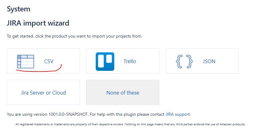

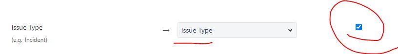

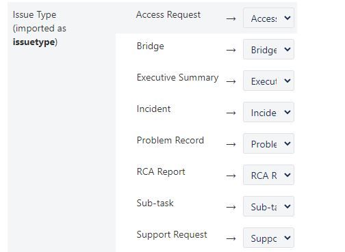

it's possible to change issue type during the value mapping in External System Import.
1.
3.
Like Claudio Gonzalez likes this
