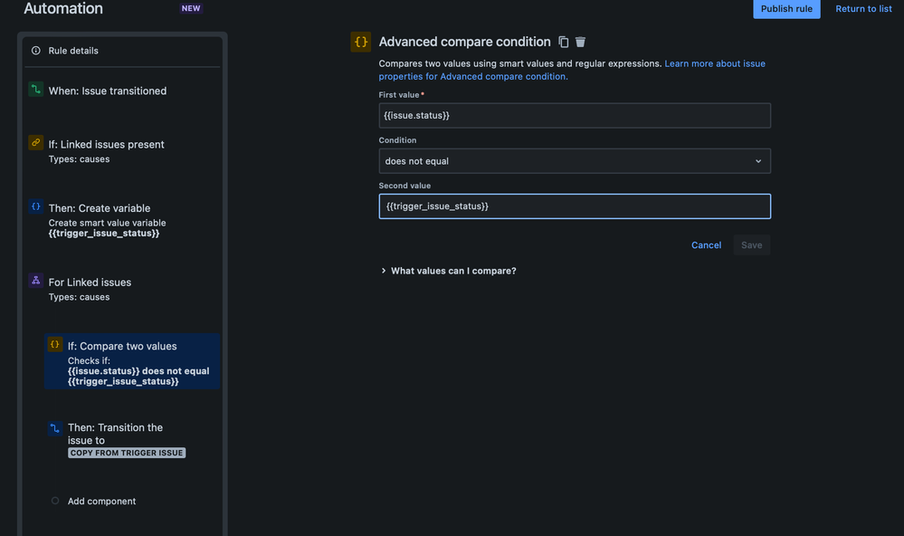

@Jonathan Fleig As an alternative suggestion, you could have the transitions happen more in real-time by triggering the automation based off of an issue transition.
Condition: if linked issues of type "causes" are present, then
Branch into the linked issue and transition the status there to the status of the triggering issue.
You could hard code the statuses here, like you did above, or you could create a variable, store the value of the triggering issue, compare each status of the branched issues, and then set the status if the status doesn't match (see below image). This would make the automation status-agnostic with just one condition check, without having to check for each status individually. (Now, there may be issues with this if admins add statuses to one project later on that aren't on the other.)
This would probably be heavier on the system since it will run on every issue transition, but I thought I'd suggest it.
