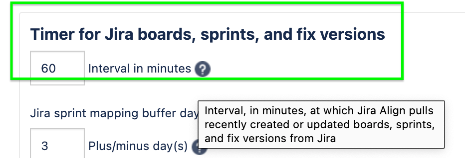

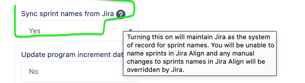

@Durga Prasad Nagireddy The behavior you are seeing is controlled by a flag on the connector...or it may just be a timing issue ...also controlled by a flag on the connector.  Both flags are shown below.
