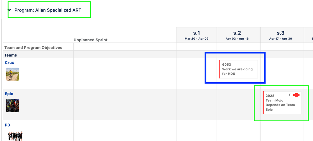

Ahh ...gotcha ...You are correct only the Team Dependencies show up in the swimlanes because the are Team-specific.  I guess it would be nice if another swimlane existed for Program/ART Level Dependencies.
  1. If the Dependency will be met by the work of one team in the Program, it can be reassigned from the Program to that team.  This will resolve this issue as you expect.
  2. If the Dependency will be met the work of multiple Teams in the Program, you could ask the requestor to create multiple Dependencies to be tracked individually.
  3. The Respondent Program could create a Feature for "All work for Dependency X" and assign to various teams.  This would give you a visual, but not exactly what you want. See pic.

@Allan Maxwell thanks for your response. Given the particular nature of our dependency being on a team that is "disconnected" (only uses Align at the feature level), option 1 won't work because the depended on team isn't an option in the team selection. That's why we chose program.
Sounds like it would just be an enhancement request to have program level dependencies show up on the depended on program's board similar to external dependencies at the bottom.
