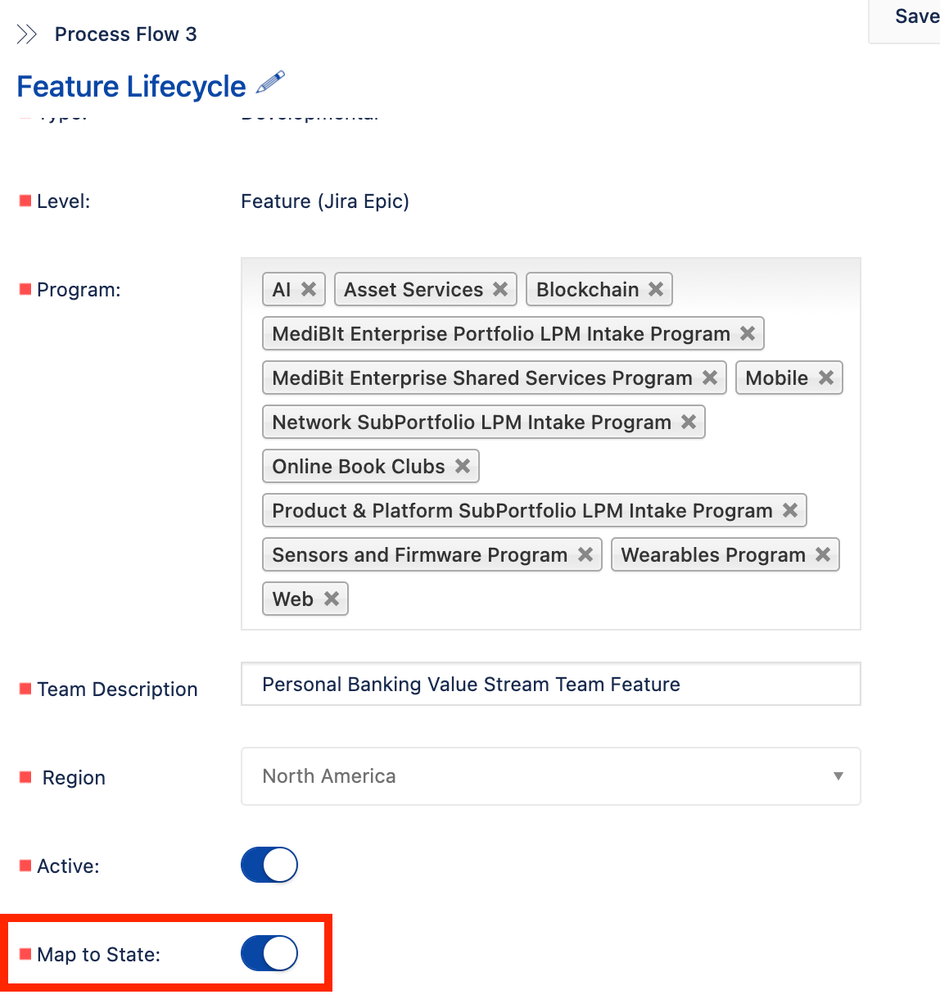

Kurt,
Had you selected that it be mapped?
If you have, then see Rae's response.

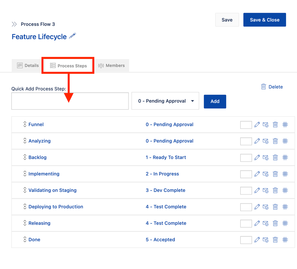

If you haven't, then you need to set up the mapping on the next tab
Hope this helped and apologies if you have done this preliminary work already.
