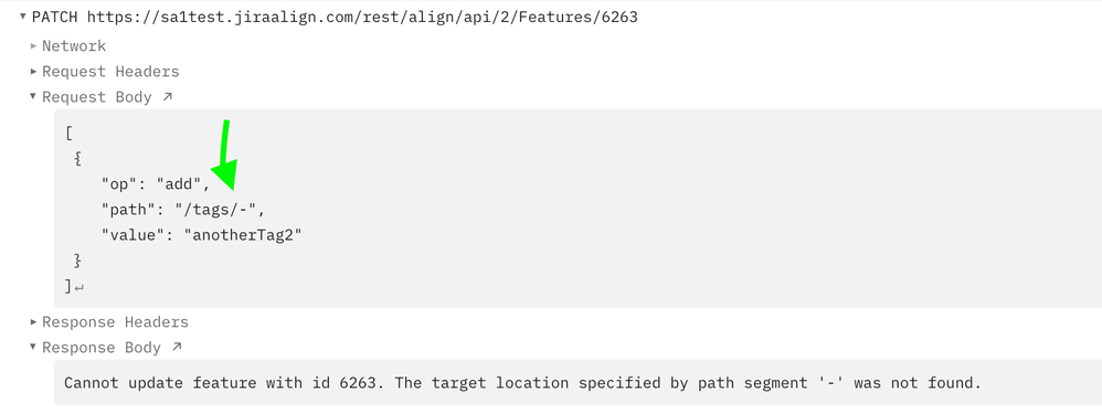

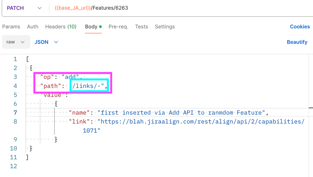

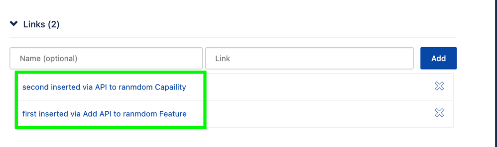

Allan Maxwell
May 1, 2024
The syntax for adding to an array is shown in image 1 and results in image 2.  Note the "/-" at the end of the "path". Image 3 seems to be indicating that it is broken for "Tags".  I have a script that I have run in the past that uses that syntax to add to Tags, so I am fairly certain it worked in the past.
I'll check if this is a known bug and report back.
