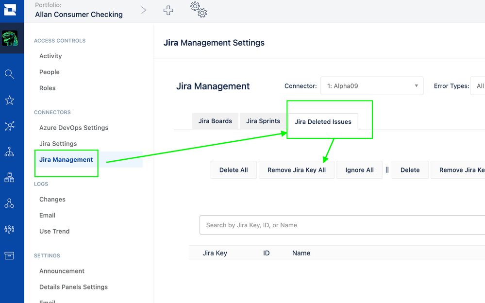

Are you aware of a Jira Align feature called the "Jira Deleted Issue Report"?  It's typically only available to Align Admins, but you might be able to have someone run it on your behalf.  It is quite possible that you admins are running it periodically to resolve issues that have been deleted in Jira but not Jira Align.
After the report is run, you will see a list of issue in Jira Align that no longer exist in Jira.  For each issue, you will have the following three options:
  1. Delete it from Align --this is the typical choice
  2. Remove Jira Key --this effectively restores it to Jira, but new Issue keys will be generated.  Essentially behaves as if you created it new in Jira Align
  3. Ignore
You want option 2, Remove Jira Key
