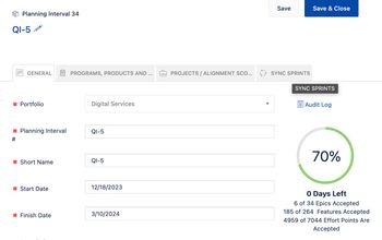

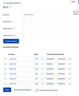

@Nena Kruljac From a tooling perspective, it is easy to make this adjustment in Jira Align if you haven't built out future PIs and mapped sprints. In this case, it is just a matter of adjusting the end date of the PI on the PI Details Panel and creating the additional anchor dates. Someone with appropriate permission would have to do this.
