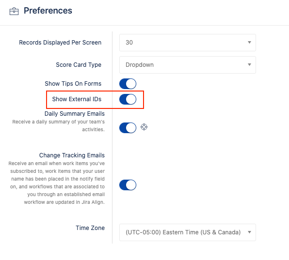

As long as a user has the "Show External IDs" toggle on under edit preferences, the External ID will show on the Program Board (vs the Jira Align ID). Each user would need to do this.

@Vinay Sharma you can display the Jira IDs for features on the Program Board by toggling on the Show External IDs in the User Preferences can be found by going to User Menu > User Preferences.
