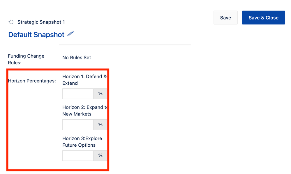

In Jira Align on the Snapshot form we have a Horizon percentage distribution. But what is that used for? Which report? Which gadget? Is it in Strategy room? Any clues?

@rateodoros
Assuming you've got all of the setup correct - and all Epics for the portfolio are aligned to a strategic horizon, this report WILL show you the actual spend (based team cost per sprint- note that sprints must be closed to affect this calculation- ) against the estimated funding made in the snapshot over each PI.  It will also total for the programs using the same method.
Short answer - AFAIK the Strategic horizon does not come into play on this or any other current report in Jira Align.
@Tom O_Connor Did I miss one? two?  :D
Hope that helps..

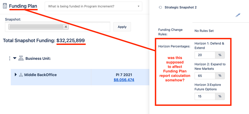

Hi, @Tom O_Connor ! Thanks for the answer, that's nice to know about the McKinsey's concepts.
I'm working right now with portfolio expansion mainly using Funding Plan report shown in the documentation 10X-Budgetary-Tracking.
However I don't see how horizon percentages affects the snapshot funding. Was it expected to affect the funding plan?
Or the percentages are just used to register how much of the budget is going to each horizon as an information?
