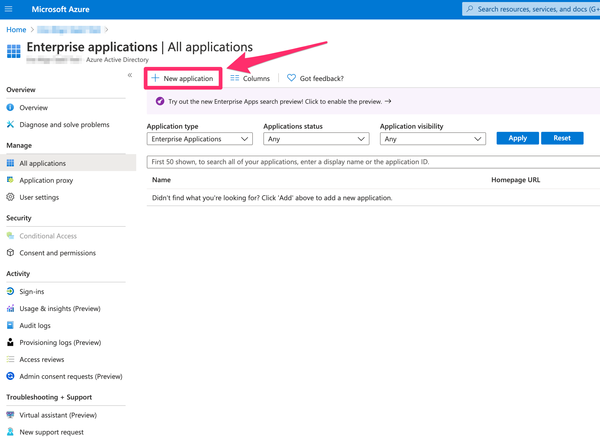

3. Click on New application.
4. Select Non-gallery application.
5. Name the application something relevant to your organization and/or the application itself and click Add. In this case, we've named it JiraAlign.

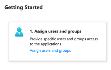

6. Under the Getting Started section, click on 1. Assign users and groups.

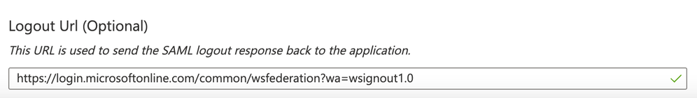

14. Please note that Azure has made some recent changes surrounding Logout URL. Please use the provided URL below and also read through the "Sign Out URL" section at the end of this article.
Logout URL: https://login.microsoftonline.com/common/wsfederation?wa=wsignout1.0

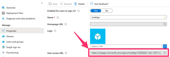

15. In the left hand menu under Manage, click Properties and copy the User Access URL for use in a later step. User Access URL will start with https://myapps.microsoft.com/signin.

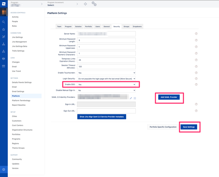

16. Sign into Jira Align and click Administration > Platform > Security.
17. Click Add SAML Provider.
18. Paste in the SAML 2.0 Metadata from Azure (Step 13 from earlier).
19. Click Save & Close.
20. Set Enable SSO to Yes.
21. Click Save Settings.

  • Once you are confident that there are no known issues with SSO, you can go back to Platform Settings from earlier and set Disable Manual Sign In to Yes.
You'll need to open a ticket with Jira Align to regain access if you get locked out while Disable Manual Sign In is turned on.
  • After you have set Disable Manual Sign In, you'll be able to fill out the following fields:
    • Sign In URL (use the URL from step 15)
    • Sign Out URL (use the URL from step 14)

I just wanted to circle back one important addition that solved the sign-out problem that I was encountering so that others would have the solution readily available:
Implementing "14. In Section 4: Set up <name>, copy the Logout URL", I ran into the problem that both my Azure Login URL and Logout URL are identical. Therefore, the logout did not work properly.
For step 14 to work, it required me within the Azure Basic SAML Configuration to add the logout url you have kindly provided:
Instead of the Logout URL from Azure, I obviously added your url as the sign-out URL in Jira Align under Platform Settings Security as well:
Now, everything works.
