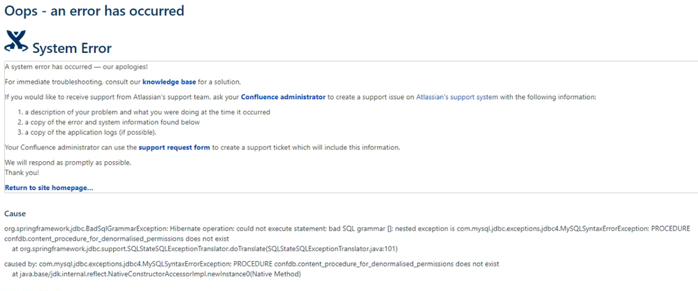

cannot edit/create page anymore after upgrading to recent version
Jing Kang
August 13, 2021
error:
content_procedure_for_denormalised_permissions does not exist

OK, you've run into a known problem in upgrading MySQL, and there's a one-off fix - see https://confluence.atlassian.com/confkb/confluence-mysql-database-migration-causes-content_procedure_for_denormalised_permissions-does-not-exist-error-1072474724.html
In the question you linked to, there's actually a second problem, in that the posters are mostly talking about Mariadb - while that mostly tends to work ok, it is not supported and should not be used for Confluence.  It often causes unfixable problems, especially during upgrades, and can lead people in circles when errors like this one happen, as they spend ages trying to use MySQL fixes which don't quite apply to Maria and hence don't work.

when click Create. it is ok to read existing pages, but not for editing, cannot save.
