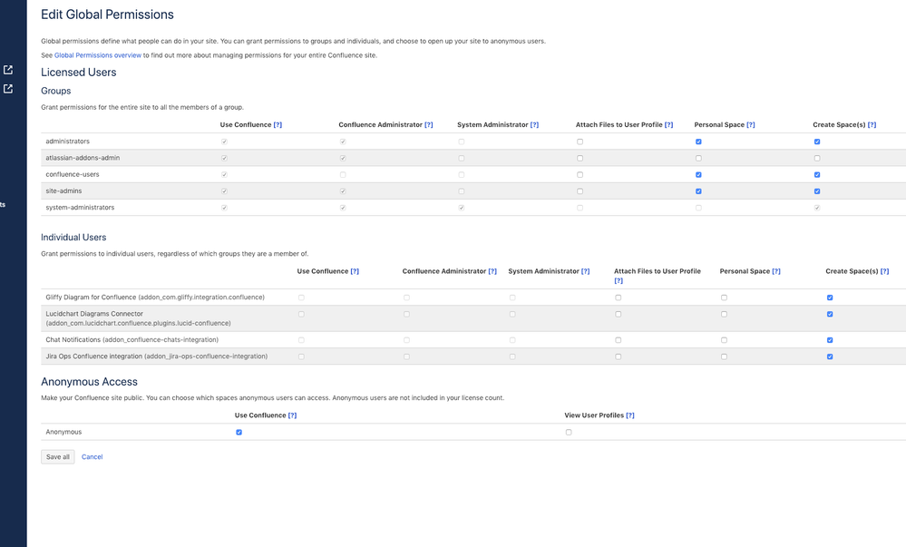

Yusuf_Mayet
December 19, 2018
Hello Roman,
This is that the Global Permissions page looks like. None of the items under the System Administrator column are editable. Those ticks are greyed out. Only the other columns to the right, I can change.
So I still dont know how to add myself to a group with System Administrar rights.
