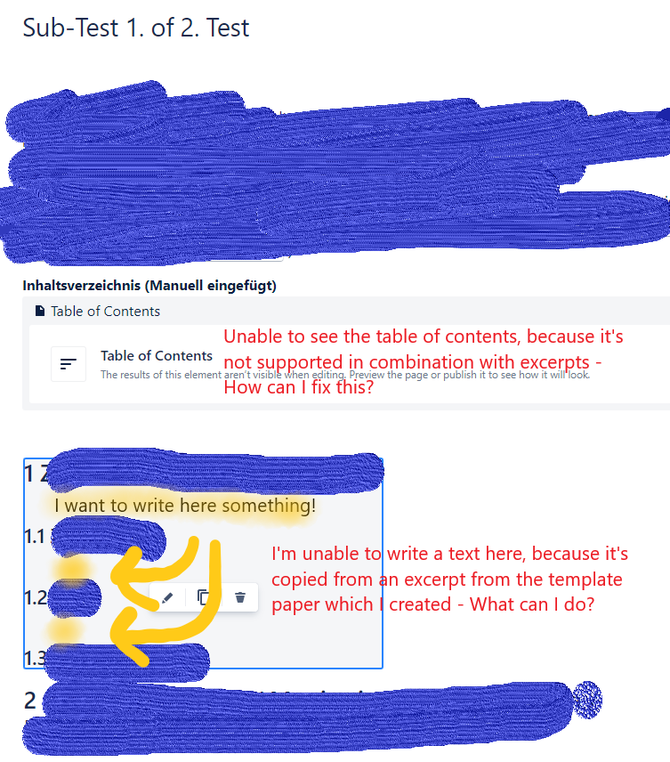

@Barbara Szczesniak Hi Barbara,
Thank you for the quick response! Let's clarify what I meant:
Our goal is to create a customer documentation template that we can use for our IT customers (Confluence is only used internal, for internal documentation!). This template consists of nothing more than a table of contents including headings for predefined topics.
How this is finally implemented is not important to me - It can really be a template and configured in Confluence accordingly, but also simply a 'page' with appropriate settings that we can copy and fill with the customer information. When creating a 'real' template, is there any way to make pages created based on it dependent, so that changes are automatically applied to the page- and synchronized? Please enlighten me, because this is what we really looking for!
Regarding your input or what we have already tried now: I created a page in Confluence (Serves as a template), added a table of contents and wrapped the headings in an excert so they would be applied to pages copied from it. But then there was just the problem that we:
1. could not add any additions within the excerts, which we urgently need to fill in customer information - How can I solve this? Generating a single excert for each heading does not make sense in our case, as we want new additions to be included - So an excert for each heading does not make sense.
2. the table of contents is not synchronized as we would like it to be (in the mentioned forum entry exactly this problem was already discussed once).
I hope I could clarify the uncertainties, please take a look at the screenshot.tempsnip.png

With regard to your excerpts, I presume the text you have redacted is the text you want to appear each time (in this case, the section headings), and you want to be able to insert custom text after the heading.
  1. If you want to use this as a boilerplate (every document should include this structure of headings), I would make a page template that includes all of the headings you want. You could even include paragraphs of text that should be included on every page or instruction text on what they writer should include in each section. You can even add Variables in your template that are used in headings or paragraphs of text.
    When someone creates a new page for a client's document, they should select this template and enter the values for all the variables. They will then be able to add whatever text they want after each heading, modify any of the boilerplate text, and insert additional headings, as needed. (start with this page for more details: https://support.atlassian.com/confluence-cloud/docs/pre-format-your-content-with-templates/ )
    In this case, a basic Table of Contents macro at the top of the page will just pick up all the headings on the page (based on the levels you include/exclude in the macro parameters). It doesn't need to be wrapped in an excerpt. Note: You need to Publish the page to see the headings included in the TOC on that page. What you see while in Edit mode is what you are showing in your top image.
  2. If you want to have content on other Confluence pages that you pull into the page for a client, you need to make excerpts that only include text that you would not want to modify or insert text in between. This may mean that you need to create a lot of excerpts, so if you are only looking at standard headings and minimal text, option 1 above might be the way to go.
Hope this helps. Maybe others have better ideas based on their experience.
