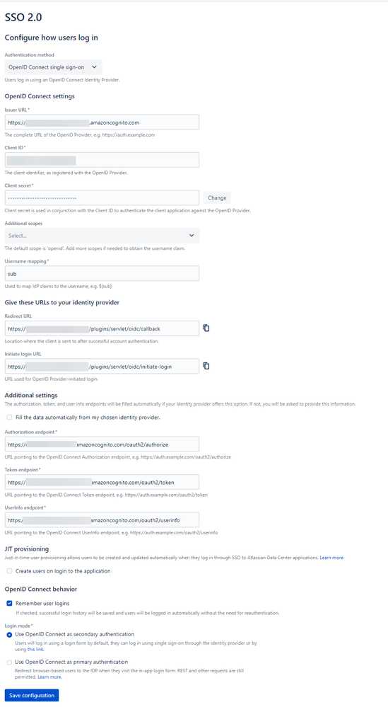

Can you paste a screenshot of the OIDC configuration in Confluence?
You may redact some information if needed.
Daniel
April 27, 2021
Sure thing @Thiago Masutti
SBXgR9L
Thiago Masutti
April 27, 2021
Thanks @Daniel
On Username mapping you need to use ${sub} instead of just sub.
See if that works.

Daniel
April 27, 2021
I tried ${sub} before I used sub, that didn't change anything .
I manually added the information in additional settings because it couldn't recognize those automatically. I opened a thread about it earlier actually but thought it might be resolved thanks to editing everything manually.
