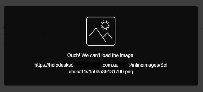

Sorry, I meant Confluence server.
We didn't realize that when you copy and paste an image when creating an article, it only copies the image source and not the actual images.
The problem now is our former Solutions System has been decommissioned, that's why we are getting the error above.
I want to know exactly where the images are stored when creating an article in Confluence.
I also want to know if we can change the image pointers from an article so that it doesn't point to an empty, non-existing online image source anymore.

Even if you have the original images, Confluence needs to attach them to the page properly and in the database. There's not really a way to do that, short of scripting this and writing to the database yourself, which would take a considerable amount of time.
To answer your question about changing the image pointers, you would need to do a find and replace in the database, similar to the procedure here: How to replace all hard coded links after a base URL change.
The best fix in both cases would be to perform the migration over again, by migrating the space from the decommissioned server to the new one. You would need to be able to bring the decommissioned server back online, which may require a site restoration.

Thank you for confirming. The Confluence Drag and Drop plugin referred to in that article is an system add-on, so it should be enabled on your site by default. In the event that it gets disabled, you can run into issues with the attachment not being added properly.
Attachments in Confluence are stored in the attachments directory in the configured home folder in the file system, by default. You can find information about that below.
Edit: In my previous message, I mentioned how if you were to manually perform the migration, it would require you to modify both the filesystem and the database. By this, I mean the references in the database to the attachments which are then stored in the file system.
It was formerly possible to completely store attachments in the database prior to 5.4, but this has since been deprecated.
The best way to solve this would be to complete the migration again using the method I mentioned. See Migrating Confluence Between Servers for more details.
