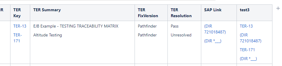

Hi @Katerina Kovriga _Stiltsoft_ , I had tried that before.
This is the way it looks with the \n in the code:

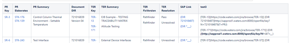

and this is how it looks after removing the \n:

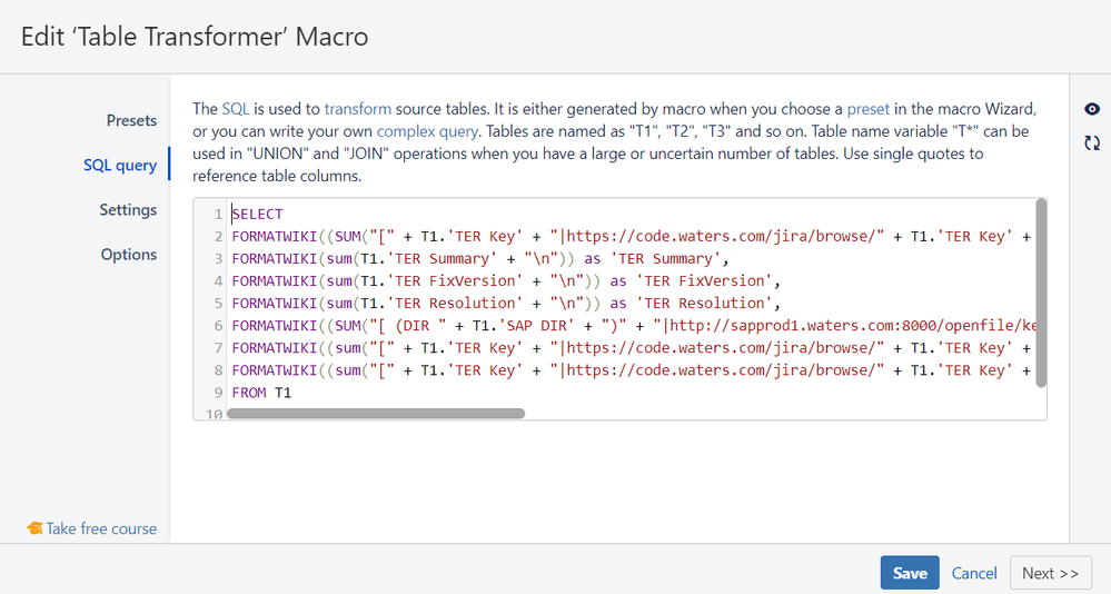

This is the code in the table transformer:
SELECT T1.'PR Key',T1.'PR Elaborates',T1.'PR Summary',T1.'Document DIR',
T1.'TER Key',T1.'TER Summary',T1.'TER FixVersion',T1.'TER Resolution',
FORMATWIKI(sum(T1.'PR Key' + "\n")) as 'PR Key',
FORMATWIKI(sum(T1.'PR Elaborates' + "\n")) as 'PR Elaborates',
FORMATWIKI(sum(T1.'PR Summary' + "\n")) as 'PR Summary',
FORMATWIKI(sum(T1.'Document DIR' + "\n")) as 'Document DIR',
FORMATWIKI((SUM("[" + T1.'TER Key' + "|https://code.waters.com/jira/browse/" + T1.'TER Key' + "]\n"))) AS 'TER Key',
FORMATWIKI(sum(T1.'TER Summary' + "\n")) as 'TER Summary',
FORMATWIKI(sum(T1.'TER FixVersion' + "\n")) as 'TER FixVersion',
FORMATWIKI(sum(T1.'TER Resolution' + "\n")) as 'TER Resolution',
FORMATWIKI((SUM("[ (DIR " + T1.'SAP DIR' + ")" + "|http://sapprod1.waters.com:8000/openfile/key?N=" + T1.'SAP DIR' + "&T=" + T1.'SAP DIR Doc Type' + "]\n"))) AS 'SAP Link',
FORMATWIKI((sum("[" + T1.'TER Key' + "|https://code.waters.com/jira/browse/" + T1.'TER Key' + "]\n" + "[ (DIR " + T1.'SAP DIR' + ")" + "|http://sapprod1.waters.com:8000/openfile/key?N=" + T1.'SAP DIR' + "&T=" + T1.'SAP DIR Doc Type' + "]\n"))) as 'test3'
FROM T1
GROUP BY T1.'PR Key',T1.'PR Elaborates',T1.'PR Summary',T1.'Document DIR'

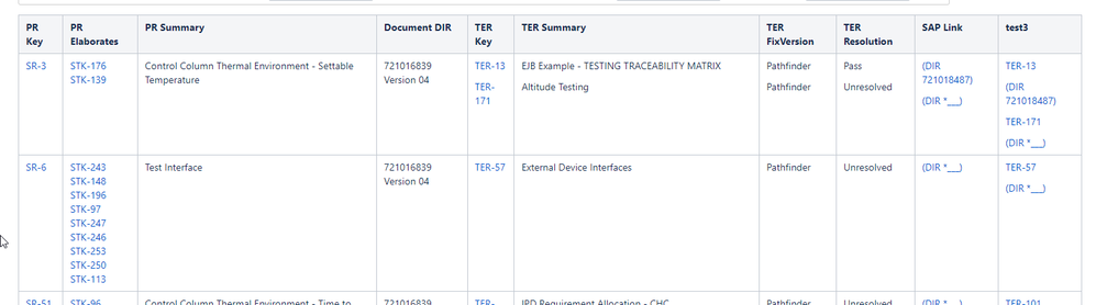

This is how the table currently looks:

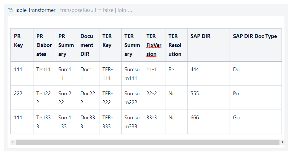

So here is my source table with dummy data wrapped in the Table Transformer macro:
Here is my query (copied from yours but without the beginning and grouped only by the first column because I have only 3 rows with data):
SELECT

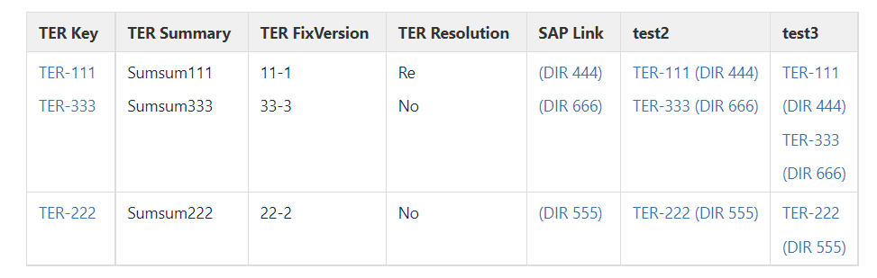

The difference between the 'test2' and 'test3' is in the \n character.
And here is the result:
The 'test3' column looks like yours, but 'test2' doesn't have an extra return.
I'm on Confluence Cloud as is shown via your hashtags. So, please raise a support ticket. Attach your page storage format and the team will look closer at the problem.
