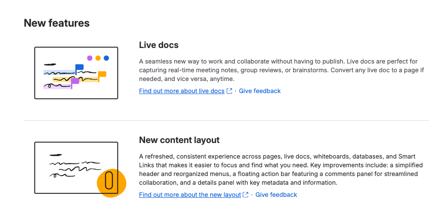

Adding one data point from a Premium sandbox where I switched Approvals on tonight and walked it end to end. What I found is that there are four separate gates in front of "Start approval", and the support page only mentions the first:
  1. Plan: Premium or Enterprise.
  2. Rollout: the feature has to have reached the site. It shows up as an Approvals row (labelled Beta, arriving switched off) at your-site.atlassian.net/wiki/admin/newfeatures. If the row is not there, no other setting will help; the Open Beta announcement comments say a support ticket can bring it forward, and sandboxes are enabled separately from production.
  3. Space mode: after that toggle, Space settings gains a "Status and approvals" item with three modes. "Enable statuses only" lets you add custom statuses but hides approvals completely; it needs "Enable statuses with approvals".
  4. Only then does "Start approval" appear in the status menu and at publish time.
Full walk-through with a screenshot of each gate here: https://community.atlassian.com/forums/Confluence-articles/Confluence-Approvals-Beta-the-four-gates-between-quot-available/ba-p/3278244. Thanks to everyone on this thread; comparing the different experiences here is what made the pattern visible.
I hope this helps.

Enabled this feature, and exactly same situation. What is "Content status"? Don't see anything relevant.

I found this option in "New Features".
https://your-company.atlassian.net/wiki/admin/newfeatures
After enabling it, "Statuses and Approvals" appeared in space settings.
Like • Sami Shaik likes this
