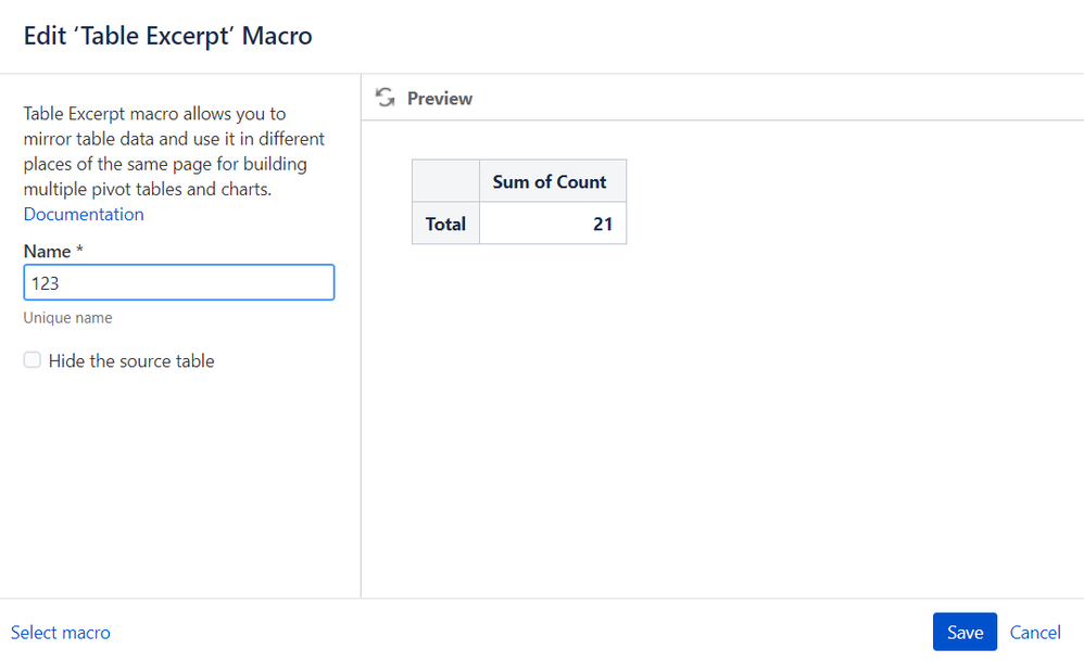

The Table Excerpt/Table Excerpt Include macros are pretty similar to the Page Properties/Page Properties Report macros but allow you to collect multiple-row tables.

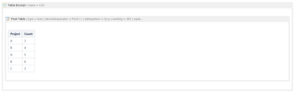

Wrap your Pivot Table macro into the Table Excerpt macro:
And give it a unique name:

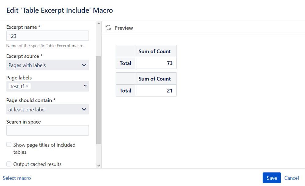

Then collect your Excerpts with the help of the Table Excerpt Include macro:

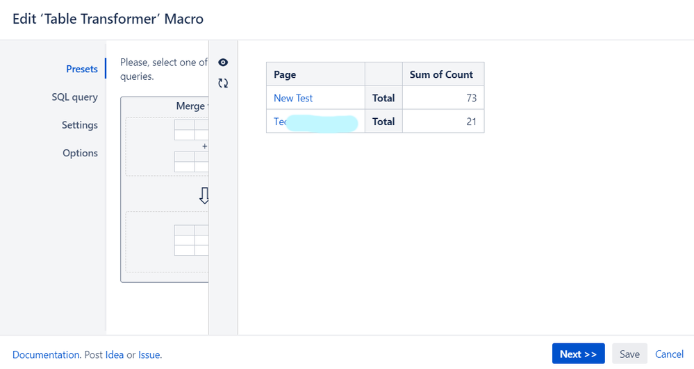

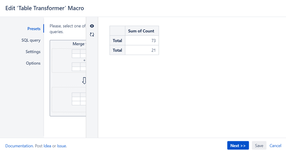

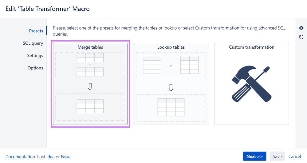

The last step is to merge your tables with the help of the Table Transformer macro:
You may also check the field "Show page titles of included tables" into the Table Excerpt Include macro settings and you'll get an additional column with a link to the page with the source table.

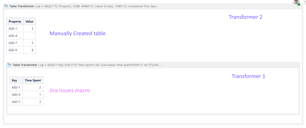

Yes, it is possible to use the Jira Issues macro with the Table Transformer macro and here is one of the examples from the Community.
What concerns your case, I've recreated the two tables manually but it doesn't matter if the second table is generated by the Jira Issues macro or manually created.
The main thing is that you'll need to match your tables by something unique. For example, it can be your 'Property' name in the first table and 'Key' in the second. Because you need to know which exact value from the second table should be inserted into the first table.

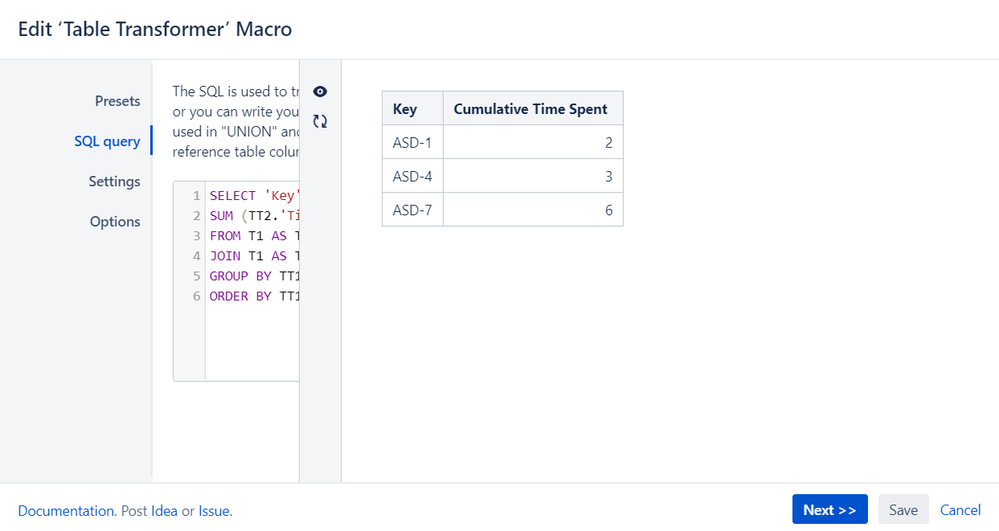

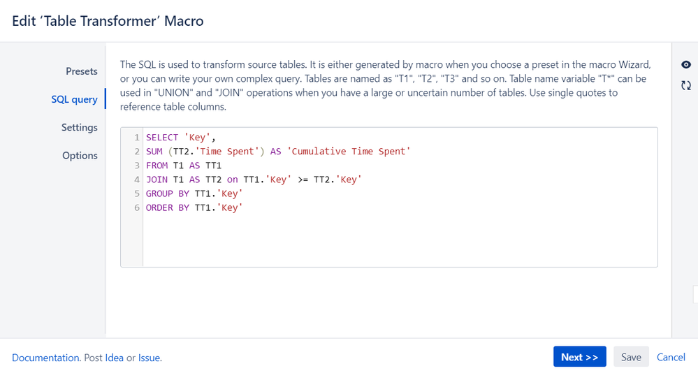

Now let's work with the Transformer 1 and count running totals:
SELECT 'Key',
SUM (TT2.'Time Spent') AS 'Cumulative Time Spent'
FROM T1 AS TT1
JOIN T1 AS TT2 on TT1.'Key' >= TT2.'Key'
GROUP BY TT1.'Key'
ORDER BY TT1.'Key'

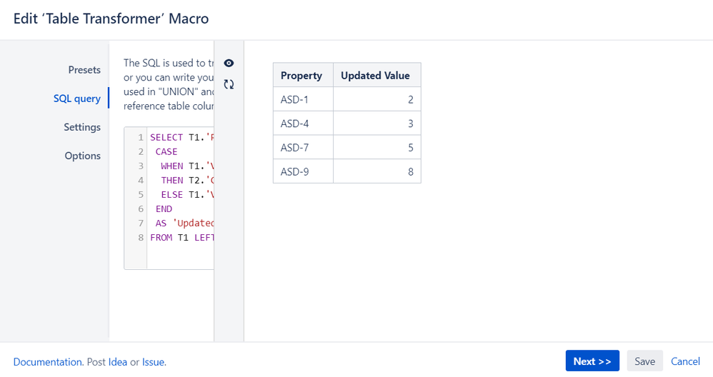

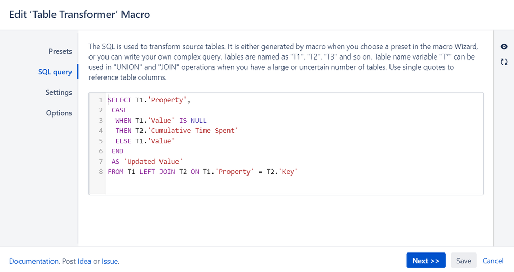

And now let's replace the empty 'Value' cells with the modified contents of the second table (we are working with the Transformer 2):
SELECT T1.'Property',
CASE
WHEN T1.'Value' IS NULL
THEN T2.'Cumulative Time Spent'
ELSE T1.'Value'
END
AS 'Updated Value'
FROM T1 LEFT JOIN T2 ON T1.'Property' = T2.'Key'
