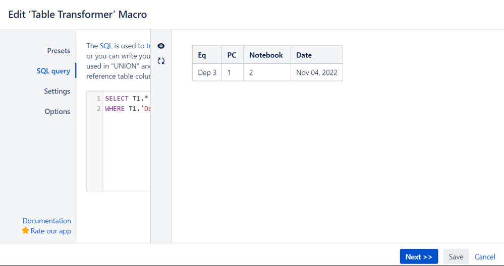

To filter your table with the help of the Table Transformer macro, create another manual table with your variable (in our case it will be month in the format coming from the Jira Issues table):

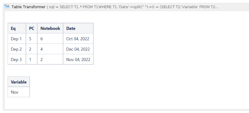

Then we cut “a month part” from the date and compare it with our variable:
SELECT T1.* FROM T1
WHERE T1.'Date'->split(" ")->0 = (SELECT T2.'Variable' FROM T2)
By changing the variable, you will change the filtered table and all the reused tables as well.
