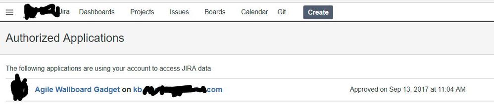

Because I like to live dangerously here are the screenshots again
Working Confluence to Jira token for jira gadget in confluence

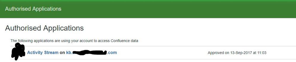

Now the working screenshot repeated itself, well the broken one is still in a comment above

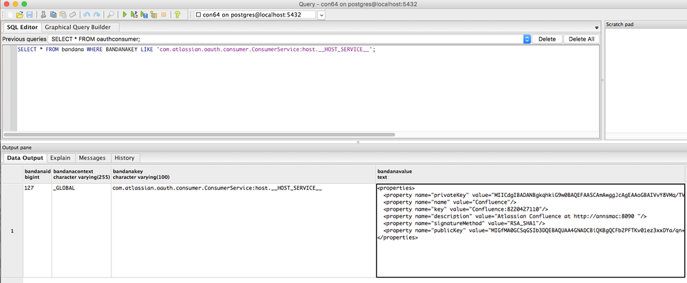

The confluence database bandana entry should have the confluence oauth information:

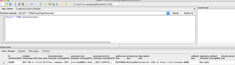

The jira oauthconsumer table has the JIRA oauth information:

Ok so the behavior is a bit different now. I am still getting the wrong url in the token description for links from jira to confluence, but there are some good things, let me explain...
JIRA gadgets in Conflunece
This I believe is working as expected.
Whenever I add a gadget I haven't added to any other page I get the Login & Approve button.
If I add a JIRA gadget that I have previously added to any confluence page I can configure it to the already linked jira without any additional steps.
If I go look at the token descriptions, they all have the proper urls.
Confluence gadgets on JIRA Dashboards
So perhaps these are supposed to work differently, but based on the way the previous linking works, when I add a confluence gadget to a JIRA dashboard that I have previously added to any other JIRA dashboard, it shouldn't ask me for a login.
Granted, I did just test whether or not reauthentication was prompted for viewing the same instance of a gadget and that has been fixed. As in, I set up a confluence page gadget on a dashboard and then went to a different computer and viewed that dashboard and I was able to view it without it asking me to login again.
However, if I try to add another confluence page gadget on the same or a different dashboard, it prompts me to login & approve the gadget again. i.e. If I already approved the quickNav gadget on a dashboard once, I get prompted for approval again if add another instance of the quick nav gadget to the same or a different dashboard. And then duplicate tokens are on the confluence authorized applications page for that gadget.
If I understand the way the gadget/token authentication should be working correctly, then there should be one oauth token per gadget. When I add confluence gadgets in JIRA its asking for a new token for every instance of any gadget.
TL:DR
JIRA gadgets in confluence pages work exactly as they should now, yay! Thank you!
Confluence gadgets in JIRA dashboards are sort of working, it no longer re-requests access every time its viewed once a gadget instance has been allowed. There are however still 2 minor issues occurring.
- The token descriptions for confluence gadgets linked to JIRA dashboards have the icon, name, and url of confluence instead of JIRA.
- When linking confluence gadgets on a JIRA dashboard it asks for a new token/approval for every instance of a gadget rather than the expected token per type of gadget.

It's found with this select statement
SELECT * FROM bandana WHERE BANDANAKEY LIKE 'com.atlassian.oauth.consumer.ConsumerService:host.__HOST_SERVICE__';
Updated with these commands that replace the strings within the value
#replacing the name string
UPDATE bandana SET bandanavalue = replace(bandanavalue,'<property name="name" value="Confluence"/>','<property name="name" value="NewName"/>') WHERE BANDANAKEY LIKE 'com.atlassian.oauth.consumer.ConsumerService:host.__HOST_SERVICE__';
#replacing the description
UPDATE bandana SET bandanavalue = replace(bandanavalue,'<property name="description" value="Atlassian Confluence at http://oldUrl:8090"/>','<property name="description" value="Atlassian Confluence at https://newUrl"/>') WHERE BANDANAKEY LIKE 'com.atlassian.oauth.consumer.ConsumerService:host.__HOST_SERVICE__';
JIRA DB via psql command line
Updated the description and consumername fields in the oauthconsumer table to be the new jira name and url and updated the oauthspconsumer table to be the new confluence name and URL.
They are viewed with these select commands
#View JIRA oauth consumer information
select * from oauthconsumer;
#View Confluence Oauth consumer information
select * from oauthspconsumer;
I updated them like this
#update Jira Oauth consumer information
#the consumername
UPDATE oauthconsumer SET consumername='newJiraName';
#the description
UPDATE oauthconsumer SET description=replace(description,'http://oldJIRAurl','https://newJIRAUrl');
#update Confluence Oauth consumer information
#the consumername
UPDATE oauthspconsumer SET consumername='newConfluenceName';
#the description
UPDATE oauthspconsumer SET description=replace(description,'http://oldConfluenceUrl','https://newConfluenceUrl');

 So now when I make a gadget macro in confluence and view the tokens page in JIRA, it has the correct information Yay!
However when I link a confluence gadget in a dashboard and view the oauth links on the confluence side it now says that its linking to itself rather than JIRA. i.e. the description shows the confluence description when it should show the jira description.
