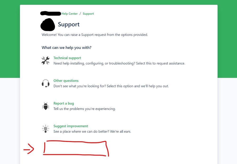

@Addactis Support&Operations I agree with you, I don't know how to share this link on my Jira Service Desk page. I know you could indeed type 'Faq/Knowledge Base' on the search and load the main landing page. However, it's not straight forward for customers sometimes.
I know also that's possible to setup a banner announcement, for bringind attention to costumers to access the Knowledge Base landing page.<https://confluence.atlassian.com/adminjiraserver/configuring-an-announcement-banner-938846985.html> However, it is not still how I would like to have on my Jira Service Desk page.
How can I add the Overview parent page on my main help center landing page from Jira Service Desk? (as highlighted in red on picture below)
I would really appreciate if someone could assist or give a better suggestion, many thanks in advance!

Hey Daniel,
I added the link into the 'introduction text' into the Portal Settings (Service Desk Project -> Project settings -> Portal Settings -> Introduction Text)
It'll just be a string and URL along the lines of:
See our [Customer Guides here|https://XXXX.atlassian.net/servicedesk/customer/portal/X/article/XXXXXX]
I.e. replace/update the string "Welcome! You can raise a Support request from the options provided." in your screenshot.
This then shows up in the main portal landing page.
Not perfect but works ok.

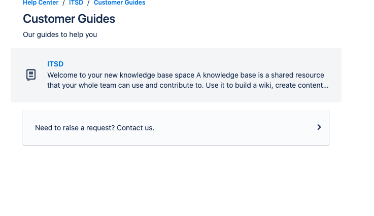

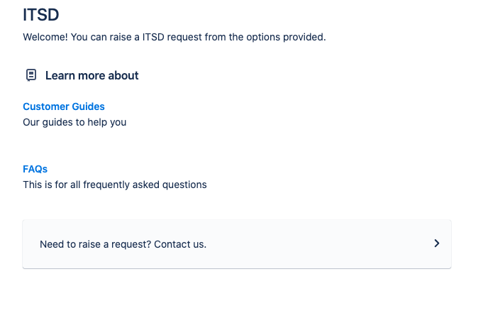

I quickly created the below screenshots to highlight functionality but you'd have better content; Here are knowledge article groups i created (customer guides & FAQs).
If I clicked on customer guides; i get the following (i've only added 1 kb article here). For high touch articles i'd add them as feature articles so they always show on top here.
Hope that helps,
Bryan
