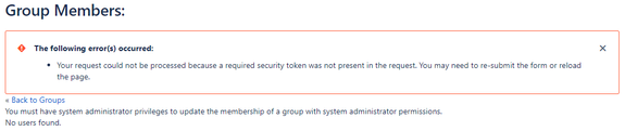

Hello Atlassian Community,
When I try to add a user to a group this error appears, however I am logged-in with the confluence administrator account :
Where does this problem come from ?
Thank you,
Mazarine

Hi @[deleted] !
Please, check the similar question and its accepted answer. It seems just like your situation:
required security token
Hope it helps.

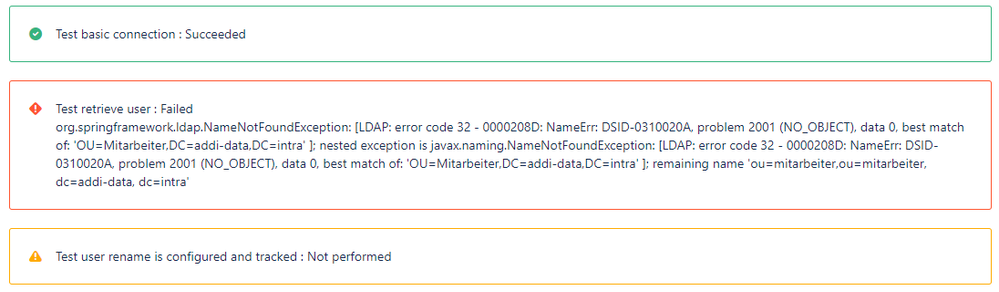

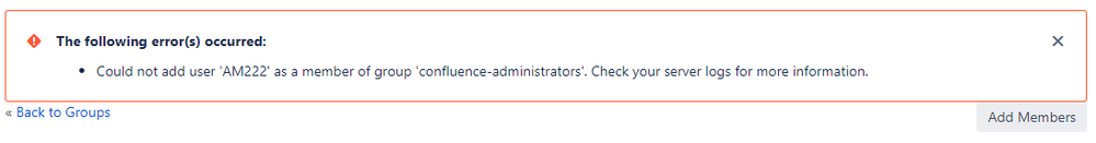

But it didn´t resolved my problem. What I´ve done :
- I have change my browser, the token error never appears anymore but now I have this error :
- I´ve change the user Directory rights (Active-Directory-Server and LDAP directory), it was read only and I set them to read/write. During the test phase both directory didn´t achieved to retrive users :
- I flushed the cache statistics.

Thank you @Grigory Salnikov  I found the solution, I have made an error in LDAP Schema.
