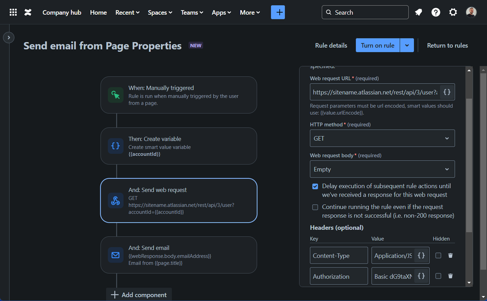

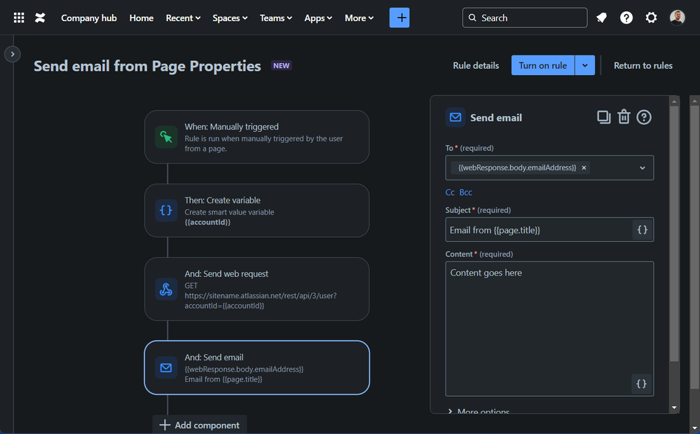

Tomislav Tobijas
December 28, 2024
@Ashok Rao I've managed to get it to work. Although, a slight notice is that this solution is based when only one user is mentioned in Page Properties table row. In order to get it to work for any number of mentioned users, you would need to adjust parsing content from the page (in this example variable part) and then probably use branch based on string of account IDs which would be stored inside mentioned variable.
Anyway, all of this is based on answer Manon provided with additional part of getting account email from account ID which is visible in the page body part.
Here's a page example:
Firstly you can create variable and use the following:
{{page.body.storage.substringBetween("Client names</strong></p></th><td><p><ac:link><ri:user ri:account-id=\"","\"")}}
This would get you ID of the account that was mentioned.
*👆 change string Client names if necessary; this is just a name I've used in my page properties table (see first screenshot)
Next, you would need to send a web request to the Atlassian site to get user details. For this, use account ID which is stored in previously created variable. Web request URL would look something like:
https://sitename.atlassian.net/rest/api/3/user?accountId={{accountId}}
For authorization part, take a look at the following article: Automation for Jira - Send web request using Jira REST API
And lastly, you can then use
{{webResponse.body.emailAddress}}
smart value and add it to "To" part of the Send email action in automation.
Hope this helps.

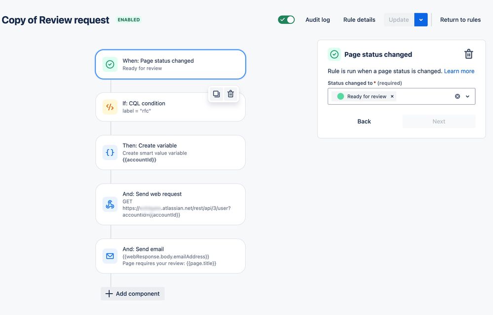

Tetiana T_
January 9, 2025
Tetiana T_
January 9, 2025
Hi @Tomislav Tobijas
I can’t express how grateful I am for your detailed instructions! I managed to make it work as well, so thank you so much!
I also want to say a big thanks to @Ashok Rao for starting this topic—it’s really exactly what I needed.
I was wondering if you could show me the principle for this part:
"you would need to adjust parsing content from the page (in this example variable part) and then probably use branch based on string of account IDs which would be stored inside mentioned variable."
I’m new to Confluence automation and all my attempts to make the flow match my use case - failed. Here’s my use case:
  • All people mentioned in the specific row of a Page Properties table need to review a page when the status changes. They all need to receive an email notification with a review request.
It works perfectly when there’s only one reviewer, but there can be more. I tried using branches but couldn't make it work, could only get 400 :) I’d really appreciate a step-by-step explanation or guidance on how to adjust this for multiple reviewers.
Thanks again for all your help!
Best regards,
Tania
Like Ashok Rao likes this

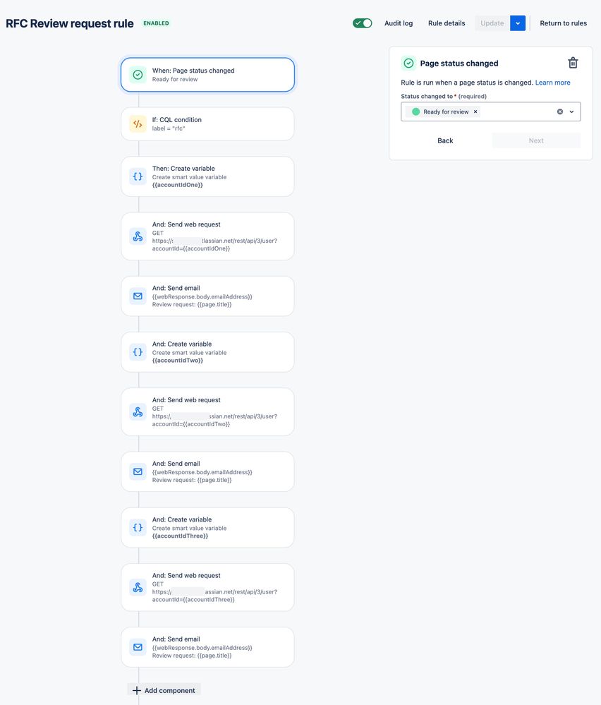

Tetiana T_
January 9, 2025
I have found a solution that works for us. It might not be the best but it works :)
We set a limit for reviewers and added a variable for each reviewer.
{{page.body.storage.substringBetween("Reviewer 1</strong></p></th><td><p><ac:link><ri:user ri:account-id=\"","\"")}}
The same for Reviewer 2 and Reviewer 3.
All mentioned reviewers are notified via email when the page status changes.
Key points to note:
  1. Ensure there is no space before the mention. Otherwise, the data won't be parsed and there will be an error.
  2. Select 'Continue running the rule even if the request response is not successful (i.e., non-200 response).' This guarantees that all steps are attempted to be executed.

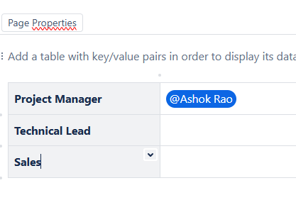

Ashok Rao
December 26, 2024
Hi @Valerie Knapp
Yeah, sure:
So, in the template, I have the page properties macro below:
I want to send a mail to the users that are filled in.
Not sure where I'm going wrong here. As I said, I'm not really very experienced in the syntax of smart values.
Thanks,
