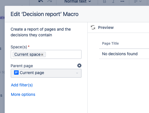

Hi all. From doing a search through the community, I found a few threads where the decision report doesn't seem to be working properly.
I have a bunch of decisions on a page and have put a decision report into the parent page. I've tried this with and without an additional filter (a solution suggested by some). But still have no luck with getting the report show the decisions.
I've even tried this with the decisions and the decision report on the same page - also with no joy.
Anyone else having this problem? Any suggestions?

This is a bug. I experience the same exact issue.
The screenshot the original question provided is exactly what I add to my macro. The page is properly published with decisions inside it and the Decision Report Macro at the bottom of the page. I’ve also tried re-publishing, publishing before adding the decision report macro and then editing, adding it with Current Space and Page: Current. Nothing.
Same filtering works fine with Action Report macros for actions on the same page

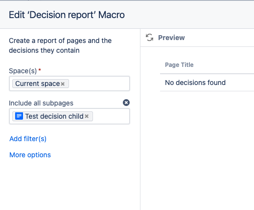

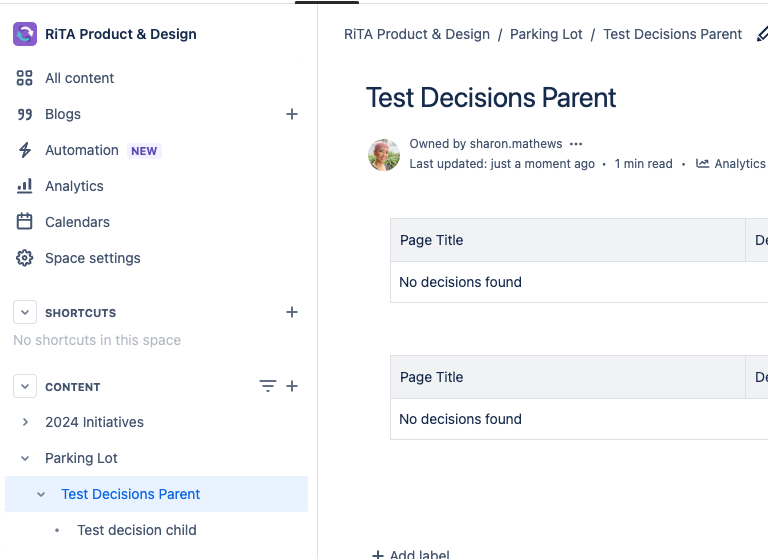

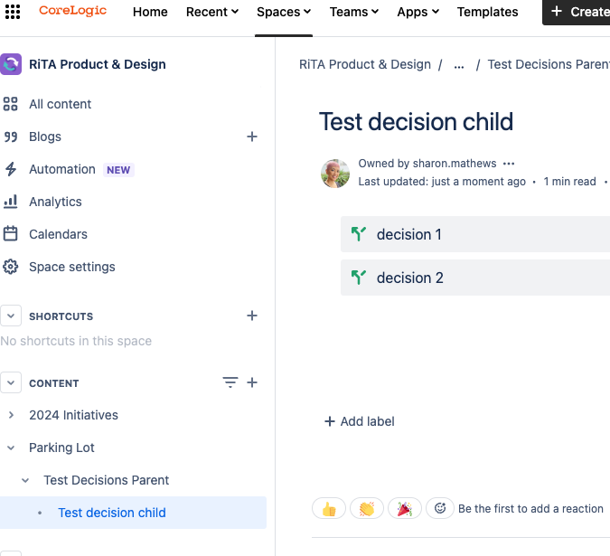

I did see that article yesterday. And yes, both my parent and child pages are published. Attached are screenshots of the parent & child pages as well as the settings for a couple decision reports on the parent page. I'm hoping that it's a simple as me not getting the settings right!
Screenshot 2024-02-28 at 8.31.58 am.pngScreenshot 2024-02-28 at 8.27.41 am.pngScreenshot 2024-02-28 at 8.31.45 am.pngScreenshot 2024-02-28 at 8.28.41 am.png
