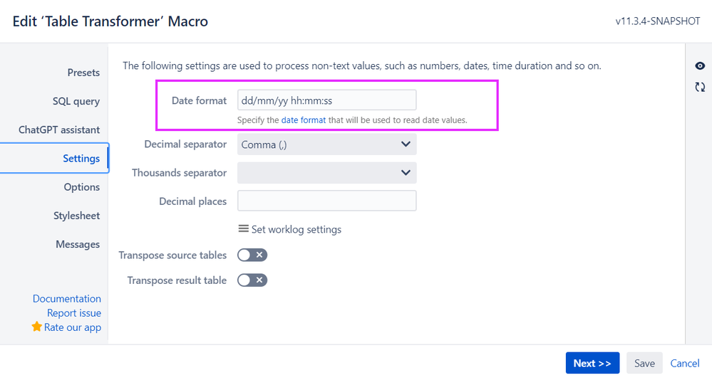

For example, for your case you may use the following structure:
Then you may go to the documentation and calculate your statuses in the internal Table Transformer macro: https://docs.stiltsoft.com/tfac/dc-server/custom-transformation-use-cases-with-advanced-sql-queries-42241587.html#CustomTransformationusecaseswithadvancedSQLqueries-Countingthedefinitevalueinacolumn

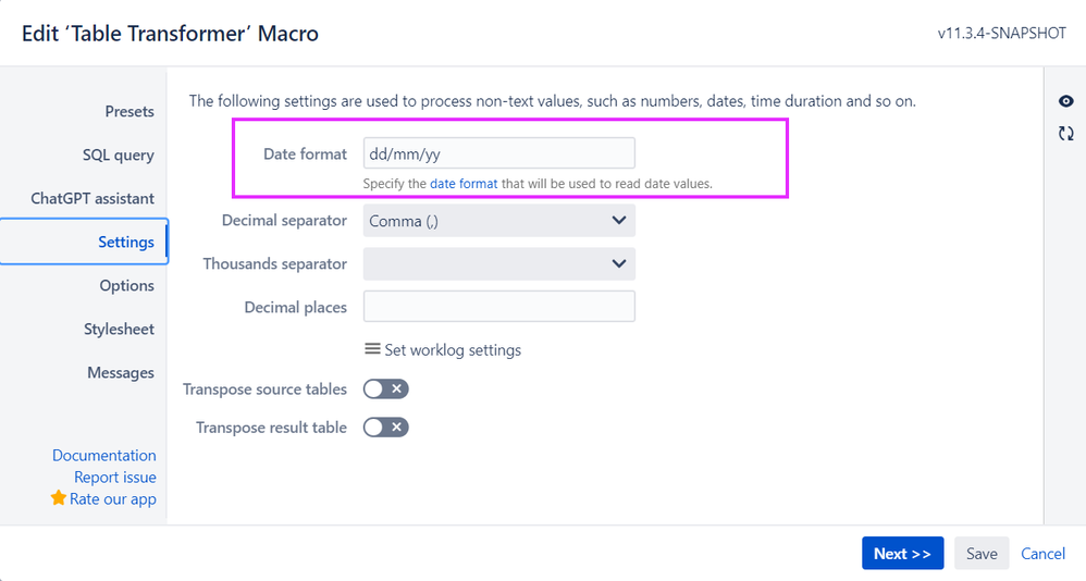

Then you may visit the documentation once more and count your numbers cumulatively in the external Table Transformer macro: https://docs.stiltsoft.com/tfac/dc-server/custom-transformation-use-cases-with-advanced-sql-queries-42241587.html#CustomTransformationusecaseswithadvancedSQLqueries-Calculatingcumulative(running)totals

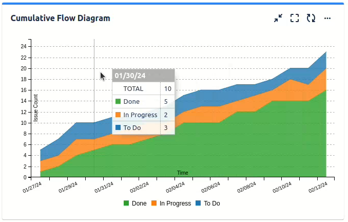

If those items are actually issues from Jira, you could use the Cumulative Flow Diagram (CFD) macro offered by our Great Gadgets app.
All you have to do is to configure the macro with a JQL that returns the Jira issues that you want to track and to generate its bands by issue statuses.
See more example of this gadget (and the many others offered by the same app), in these articles:
