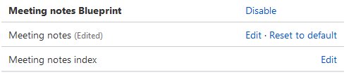

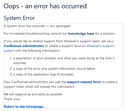

When I moved to the new site, these edited blueprints seem to have broken, and we cannot use, edit, or reset them to default. When we try any of those actions, we get taken to a page that says "Oops - an error has occurred." We are not sure what about the transition did this, but I can only imagine that something did not copy over correctly.
Below is an example of the "Edit" and "Reset to default" buttons I am referring to, along with the error I get.
What I have done in the interim is disable them all and make new global templates for my team, but it would nice to ensure these are functioning in case someone in the future wants to use them. Conveniently for us, we do not care if we lose those edited blueprints.

Thank you for reporting this issue to us too. I found some examples of this for other Confluence users when editing the Blueprint templates. When the template is removed and recreated, it fixes the issue.
I went and created an internal request for this as well, so we can have a look at the templates in your database. There's a query we'll be able to run in order to update it and fix your issue, and you won't have to lose the templates you already edited.

Just confirming that it looks like we were able to correct the broken reference in the database, and so your templates are working as expected now, without any data loss.
