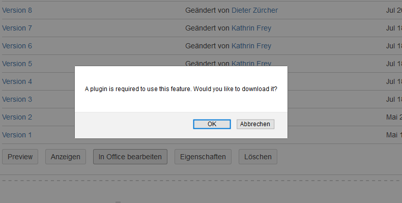

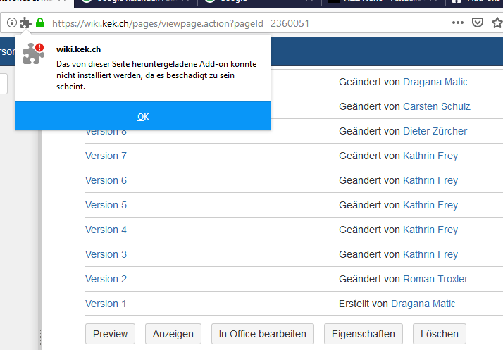

I don't think there was an active finding of an App.
Our shared working area is wiki.kek.ch. The user tried to open a document within Wiki/Atlassian to work on it, so it would be automatically updated for everyone who works with our Wiki-platform.
The first message is then: "A plugin is required to use this feature. Would you like to install it?"
The second message is: "The add-on downloaded from this page cannot be installed as it seems to be corrupt."
The photos to these messages are attached.

Ok, so this is something that is not being added via the standard UPM - you already have a plugin that is finding your users trying to do something that requires another plugin to use it, and it's taking them off to try to install it.
I would work from the interception point, rather than guess.  What is the document that the user is trying to open?  (Not the actual document, but the specific type - word, CAD, pdf, etc)

The behaviour you are facing and the procedure described makes me believe that the user was trying to use the Edit in Office feature.
The situation is better described under this bug report:
CONFSERVER-40289 | WebDAV Launcher Office Connector is broken in Firefox 43.0
The workarounds provided there are the following:
Workaround 1
  1. Download the plugin directly from mozilla (using Chrome so it doesn't auto install) https://addons.mozilla.org/firefox/downloads/file/259818/webdav_launcher-1.0.8-fx.xpi
  2. Go to about:addons, then Cog Menu > Install Add-On from file and select the .xpi file
  3. Click Install on the pop-up box, then Restart
Workaround 2
  1. Go the location bar and enter about:config
  2. Click I'll be careful, I promise!
  3. In the new Search field at the top enter xpinstall.signatures.required
  4. Double click the entry to make it false
You can also put this entry in user.js in the firefox profile directory
user.js
user_pref("xpinstall.signatures.required", false);
The plugin will now work.
A similar behaviour can also appear in Confluence Cloud instances. Another customer recently faced this behaviour there:
Atlassian Companion Availability | Atlassian Community
Let us know if this helps the user!
