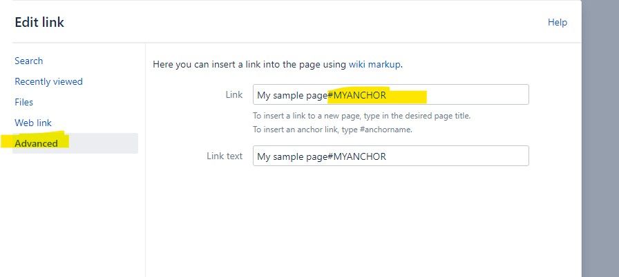

All, I was having this problem until I realized something...you can't select the page you're linking to, then go and add JUST the anchor in the Advanced field.  You have to go to Advanced and add BOTH the page name, the "#" character, and the anchor name (keeping in mind it is case and space sensitive).  That made it work for me.  Frankly I find that confusing and not documented accurately or clearly here https://confluence.atlassian.com/conf76/anchors-1018768661.html#Anchors-Step2 , but hey, go with what works. :) We are on Server 7.4.1 FYI, but I suspect this is true going back many versions.

This worked for me ... finally!  (at least within Confluence) ... I guess I have always missed the 'Advanced' recommendation.  I have not been successful with anchor links from external pages , but will try again.
