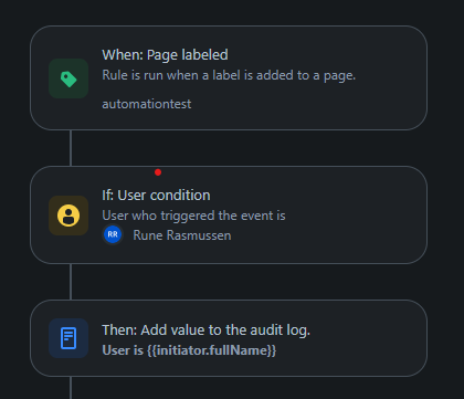

I just did a quick test using the same Smart Button template and a second automation that is triggered when a label is set (that will trigger by other automations).
It is possible to apply a User Condition to the second rule, and have whatever happen that you want accordingly.
Josef Žáček
January 17, 2025
Thank you for your quick test and screenshots @Rune Rasmussen !
Koloman Pfeffer
January 16, 2025
Short answer: Yes, it's possible.
Long answer: It depends. If the second rule is triggered by the first rule, then the rule actor of the first rule will be regarded as the person who triggered the second rule. So any user restriction you set in the second rule will always only check the actor of the first rule. If you're fine with excluding this rule actor from your use case, then this will work. But the rule would then also trigger, when the actor of the first rule adds the label manually.
