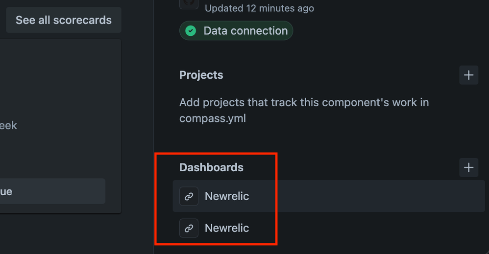

I am encountering a duplication issue when adding Links to compass.yaml files. Whenever a new Link is added to my compass.yaml file, the Link is duplicated in the web UI.

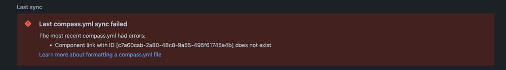

If I then make any subsequent update to my compass.yaml, such as adding a label, I encounter the following error:
Last compass.yml sync failed
The most recent compass.yml had errors:
  • Component link with ID [c7a60cab-2a80-48c8-9a55-495f61745e4b] does not exist

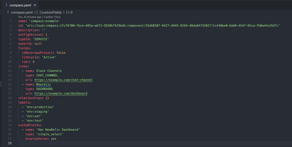

compass.yaml file
id: 'ari:cloud:compass:1fcf6700-7bce-485a-ab73-3920bf429bdb:component/35d68507-9427-4945-9269-48da84743027/1c448be0-6a60-454f-95ca-7b0a44cd547c'
description: ''
configVersion: 1
typeId: 'SERVICE'
ownerId: null
fields:
  isMonorepoProject: false
  lifecycle: 'Active'
  tier: 4
links:
- name: Slack Channels
  type: CHAT_CHANNEL
- name: Newrelic
  type: DASHBOARD
relationships: {}
labels:
  - 'env:production'
  - 'env:staging'
  - 'env:uat'
customFields:
  - name: 'Has NewRelic Dashboard'
     type: 'single_select'
     displayValue: yes

Screenshot: Duplicated Link in Web UI
Screenshot: Error encountered on the subsequent update after the duplication bugupdate-error.png
Screenshot: compass.yaml file

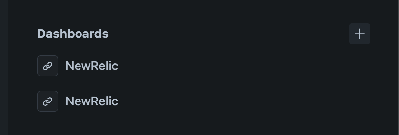

6. I pushed a new update and again observed duplicate links:
