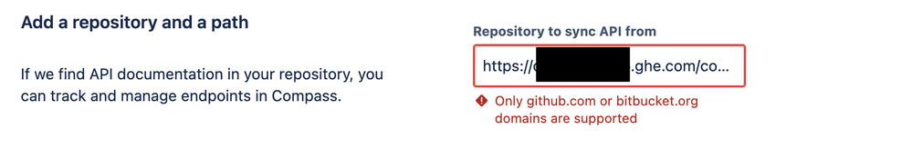

Hi @Enrique Serrano Valle , I think we've figured out what the issue is and it's a bit disappointing..
Compass for Atlassian does not currently seem to like the Data Residency Versions of Github Enterprise i.e the XYZ.ghe.com therefore we are unable to use any of the abilities on Compass to connect to our Github.
Webhooks say that the data has been delivered succesfully but nothing updates on the component itself and the other method returns a validation error as per the screenshot below..
It's a bit disappointing

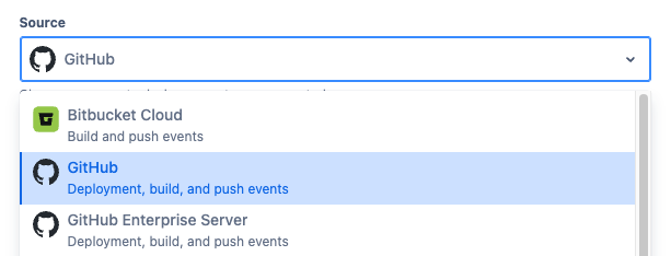

June 9, 2025
@Tyler Cassar that's likely the case - if you're using your own subdomain under `ghe.com`, the GitHub Forge App wouldn't support it.
But the incoming webhook route should be able to receive activity events from a Cloud instance and calculate metrics on them.
GitHub Cloud would go on the top webhook type (not the Enterprise Server below) as the payload is different. Is that what you have tried? I believe that would route your events to a Component with a matching repository URL, even if that were a `ghe.com`.
